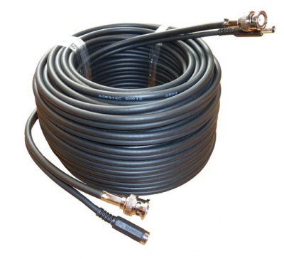

Hi shotgun cable .... Has video and power together or use cat5
I guess I'd have to fish a power cord to camera too. I don't like fishing something like a power cable through the wall.
All are electrical is in conduit here, not Romex.
I vote for cat 5 if it works for whatever you're using. It's the most versatile cabling.

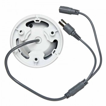

I'm new with these camera systems obviously, but how can you tell from the description and specs in the link that it accepts PoE cat5?
Here's a pic of the back of the camera. Not sure where a cat5 would go:
You may be able to use a balun like what is used on analog composite cameras. It's a cheap little adapter that essentially allows the signal to go over one pair in the cat5 cable. In the past I've purchased several thru eBay; they are probably $2 a pair, but whether it'll work with TVI I don't know.

Hi . It can't be made much easier .... Like I said in another post ... Give them the cable length you need and it turns into plug and play
OK, since those cables are are $27, it looks like it would be cheaper the get the balun they offer for $10. I'm unclear on the length of the cord for the power supply they list as an option and couldn't find any sold individually on the website so I guess I'll just call them and ask. I have no idea how I'd make these cables look decent though coming out of the wall.
