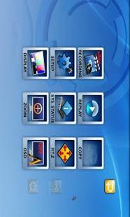

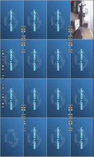

ppp 3 Posted December 9, 2016 I found https://play.google.com/store/apps/details?id=com.camdvr.aDvrMaster The aDvrMaster is an application for managing your DVR and Video Server. You can see the screen of DVR monitor at your android display and easily set your home DVR from your android phone. - Supports up to 16 camera stream - Supports Terminal mode. - Realtime frame rate (up to 30fps) support. - Three quality levels for available bandwidth. - Pantilt control (up, down, left, right, zoom, focus) with very similar menus, but it didnt work too Share this post Link to post Share on other sites
tomcctv 187 Posted December 9, 2016 Hi. You can't turn old systems into new. Your system is too old made before the days of apple and android. Symbian Java ... Would of been the remote viewer Share this post Link to post Share on other sites
