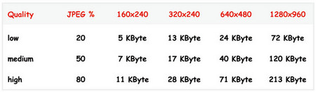

concerning the the file size here is the chart:
i'm using 70% quality
more technical info here: http://www.mobotix.com/eng/technology

bandwith tests in live mode with audio channel
mx 22 / 10 ips / mega / jpeg 90% / BW:
max transfert rate : 445kb/s
average transfert rate: 350kb/s
mx 22 / 4 ips / mega / jpeg 70% / BW:
max transfert rate : 180kb/s
average transfert rate: 130kb/s
