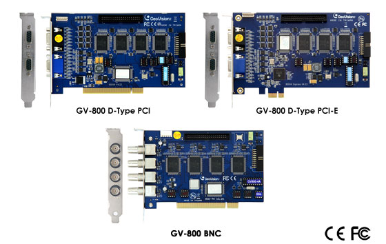

GV-800
You can't read it in the pic but the encoders say Conexant Fusion 878.

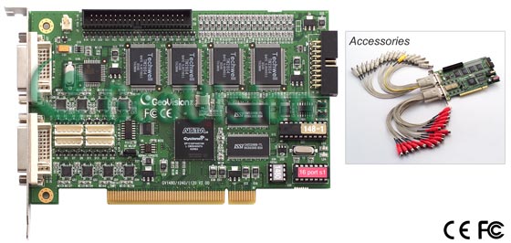

Combo card
Obviously says "Techwell" on the encoders, IIRC thats a Samsung product.
Like I said before the 2004 and 2008 have heatsinks so you can't easily read what they are but the Conexant Fusions can only do MPEG2.
All of them up to GV-800 are.

On a combo card the video controls (Sat,hue, etc...) all have different numbers then on the 800's and down, leading a person to believe the capture chips are different. The smart record feature is also grey out on the 1120/1240 cards.
