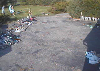

Some random group of kids (who went on to break into a house 2 doors down from me, but never got any closer to my house than this). This allows me to tell that there were people there but is useless for identification.
This is close, but still a useless blob instead of an identifiable person

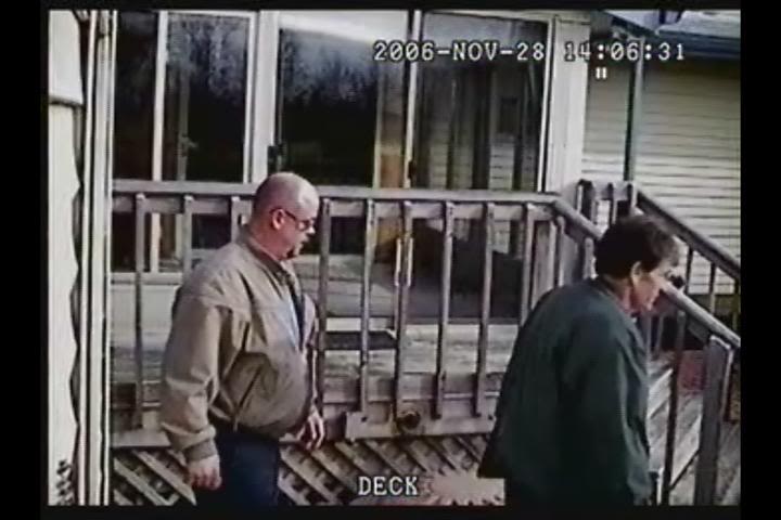

Now we're talking.
I always dedicate each camera to asking one of the following questions;
"Is there someone there?"
"What are they doing?"
"Who is it?"
This camera was very picky. It had to be close enough that the door took up the whole shot - otherwise the open door would allow too much light in and cause the door to be washed out and the background to be too dark, resulting in a useless silhouette of a person. By moving the camera 18" closer to the door the lighting is much more consistent throughout the picture and therefore I get a better shot of the person. This kind of shot is what I call the "Wanted Poster" shot. This is, to me, the aim of CCTV evidence when it comes to tracking someone down (the only thing better than this would be the license plate shot)

The one constant in every case that I have deal with using my camera systems is the action always happens almost (of not completely off-camera.) It usually is a failure on my part to adequately predict where the action will happen. I point a camera at where I think the action will be and then someone does something completely unexpected and catches me with the cameras pointing the wrong way.
Example:
