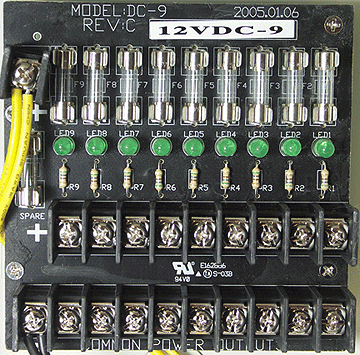

Dc-9 power supplies like this?

They are regulated but not a 1.5amp per, (only 1amp per) but are fused.

They would not be able to handle a high-power IR camera. Some of them draw as much as 1.5A per camera. There are other manufacturers who make higher capacity 12VDC power supplies:

Thanks for the information. My system is a small home system. I will never have more than 8 (analog) cameras. I currently have 4, 2 are 100mA and two are 350mA.
I am considering a one larger IR camera. With the DC-9 (1 amp) system couldn't I connect the camera to 2 outputs and get 2 amps if needed?

It all depends on the design of the power supply output buss. First of all, don't parallel fuses. Tolerances in them will probably cause each to blow, even if you are drawing less than 2 amps. If there is a single regulator connected to multiple fuses, you could replace a 1 amp fuse with a 2 amp one, as long as your total peak load for all cameras doesn't exceed the maximum allowed by the supply (leaving at least 20% wiggle room).
