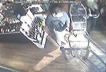

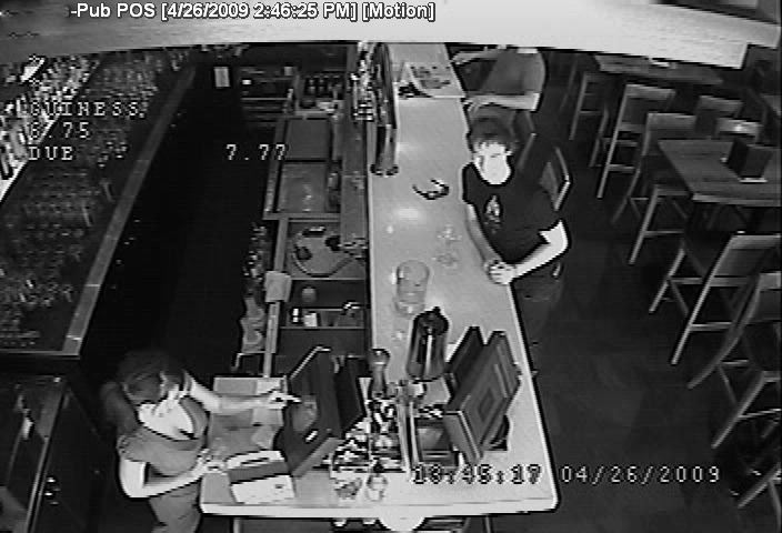

MACE analog dome camera, 1/4" sensor, 3.6mm lens, recorded at 1CIF:

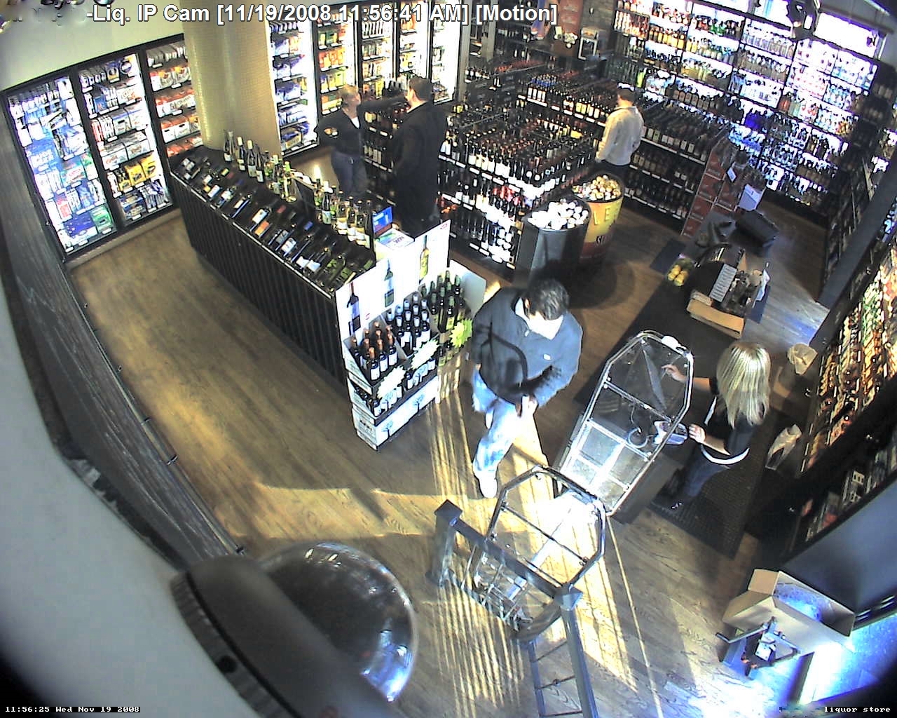

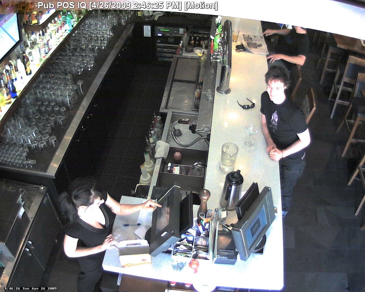

Same position, IQEye 511, 1/2" 1.3MP sensor, 2.8mm lens (note dome camera at bottom of frame):

Another example... same establishment, one a MACE dome, the other an IQ511 mounted right beside it. The dome runs through a TVS text inserter (see upper-left) and was left in place specifically for that function, as that's one thing that's not yet easily duplicated with an IP camera.
Both snaps taken at the same instant.
MACE dome, 1/4" sensor, 3.6mm lens, recording at D1:
IQ511, 1.3MP 1/2" sensor, 4-12mm varifocal lens adjusted to give approx. the same FOV as the dome, mounted to the dome's immediate right:
In the video, you can clearly see exactly what the servers are entering into the terminal screens.
BTW, this site was another one of those instances where all I needed to do was show the owner a couple shots from an IQ installation on another site, and his immediate response was, "I want that." Sold him three cams for this store, and one for another he owns.
