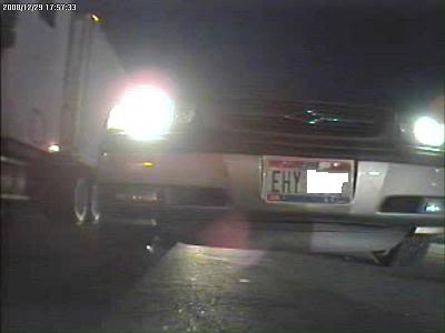

Cameras with fixed iris lenses are terrible at handling extremes of light. A car with it's headlights on facing towards your camera will blind your camera. An auto-iris camera will do better but you're still likely to have problems reading the front plate because the plate will be relatively dark compared to the rest of the scene.
Solution? Some kind of additional illumination (IR, 950nm to be invisible to people) and an IR pass filter on the lens will reject all non-IR lights. It'll turn the scene to black and white but will give you a much better chance of seeing the plate.

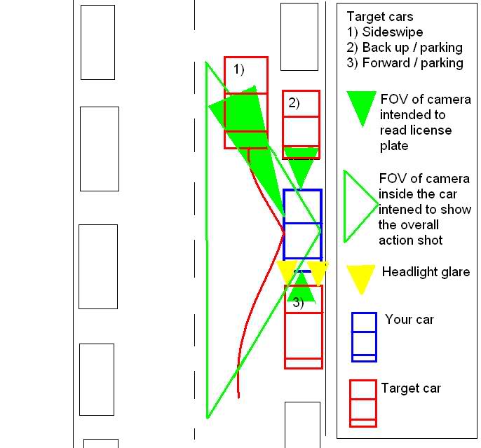

2) Field of view:
- Wider means less camera to cover the whole area, but less chance of catching the plate. Tighter means more chance of catching the plate (if the car comes into view) but less chance of the car passing through the field of view.
Solution? Try to predict where the car will be when it hits you. If you are talking about people sideswiping you on the way past then you could try to mount one camera facing where the rear plate will be as the car is driving away. If you park on the road (facing with traffic, not against it) then you can have one auto-iris camera fixed on the lane immediately to the front/left of your car at about 45deg. The rear-facing camera will face the opposite lane to catch the rear plate of those cars - however I'd be surprised if you were sideswiped by an oncoming car as it would have to be on the wrong side of the road to hit you....
If you are worried about someone bumping into you as they parallel park then you can try a camera mounted at bumper level - the light level might not be a problem because once the car gets close enough to hit you it's headlights won't be shining on the camera. A camera mounted at the front also will do the same job.

This setup would require 4 cameras. The front/rear bumper cameras could be relatively cheap non auto-iris. The diagonal license plate camera would need to be auto-iris and possibly even with an IR cut filter / IR emitter so that it can deal with the glare of taillights that the wider FOV will give. You also need one overall camera that will explain what the target car did. License #s are useless unless you can prove the car with that license # did something wrong.
Not a final solution - just a starting point for discussion.

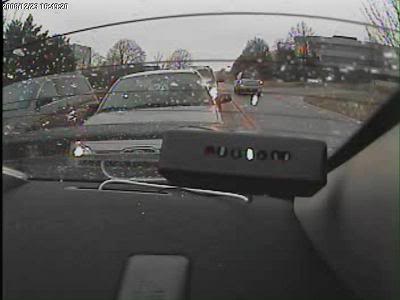

The rear-facing camera in my car is attached to the rear window using suction cups and it gives a relatively good view that is protected from the elements. However it's looking through tinted glass and is not able to read license plates.

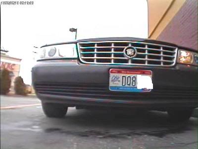

So I mounted a cheap fixed-iris weatherproof bullet camera to the top of my towbar. Next time I drive anywhere I'll pull the video and compare. With the camera in it's new location it should get plates from anyone who hits the back of my car (either in a parking lot on on the road).
I'll post the results of the road test.
Ok, here's the comparison of the In-The-Window camera versus the On-The-Towbar camera.
"In the window"
(Waiting at a red light)
Pros:
- Higher angle of view - can see either side of the vehicle behind me even if he's almost touching my bumper.
- Inside the car is protected from the elements
- I can use the little black box that shows what my brake lights/turn signals are doing
- Can use an 'indoor' camera
- Higher angle means cam won't be blinded by low beam headlights. (although at night you only see headlights)
Cons:
- Limited FOV due to the roof/parcel shelf/c-pillars
- Tinted window reduces colors and makes it almost useless at night (can only see headlights)
- Not able to see license plates
"On the towbar"
(Starbucks)
Pros:
- License plates!! If someone rear ends me (while parked or on the road) and they run then I have a good chance to getting a license plate to give to the police.
- Better lighting and colors.
- Although low beam headlight may blind the camera at regular following distances, once the car gets close enough to do any damage the headlight are no longer going to be visible the the camera.
Cons:
- Low angle means if a car is almost touching my bumper then that's all I'll see.
- Have to mount my taillight box in view of a different camera.
- Have to use a weatherproof camera and mount it in a way that won't allow it to be damaged under normal driving conditions (ie high slope driveways that sometimes catch my towbar, or if I back into a snow drift.)

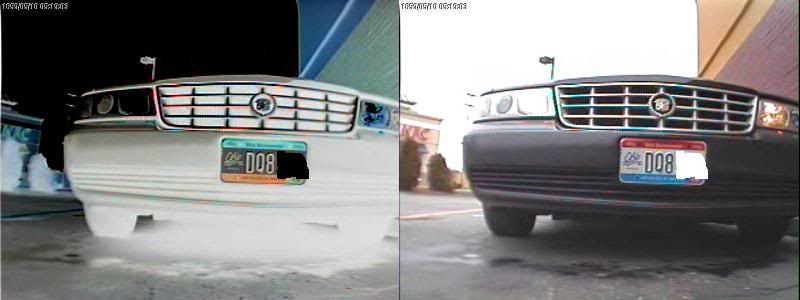

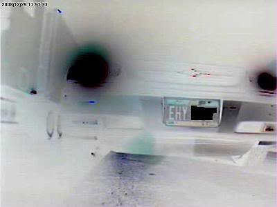

I noticed in the post about license plate recognition that NEGATIVE VIEW never comes up.
I believe negative view will give you a better license plate shot than regular cameras.
Negative view is worthless for normal video shots.
This may not be the camera of choice for mounting on a vehicle, but it will give you a frame of reference to get you started for looking for an IP 66 rated bullet with the same features as this one:
http://usaginc.com/viewspec.php?sku=US-PC-405
The spec does not show it, but this has the negative view.
If you are a dealer then you can call Juan Gayo, and tell him Scorpion sent you at 1 954 570 7655 and he can set you up with a demo over the internet with a license plate that they have screwed to the wall. I am sorry for the end user as this demo is not available.
What do you guys think about negative view for license plate recog?
Can I do the same thing by loading the jpg image into Photoshop and doing a "negative colors" filter? I have used photoshop in the past to adjust the brightness/contrast/hue of an image to make a plate more readable, and I have tried a negative view also. But that's in post-processing - I've never tried a negative camera...
The negative view would be useless as a dashcam - ie it would render that camera as a license-plate-only camera.
Is there something about the video being in negative that would make the plate easier to read? I have found that sometimes the interlacing of a full D1 image causes those jagged edges on objects that are fast-moving enough that the object moves between the two interlaced D1 frames. That makes a plate tough to read from a paused video image. The plate can be easier to read when played back very slowly verses just paused.
I tried searching for examples of license plate cameras using negative images, but couldn't find any. Do you know where I could example pics?
Yes!
I think your photo gives a good example of how the camera would do it!
The words in the red area of the plate seem to "pop" out a little better in the reverse image.
Scruit can explain to the others how the green is the opposite of red in the color wheel, and that is why that area turns green in the reverse image.
