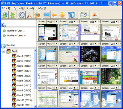

xiaokaige   0 Posted November 27, 2012 You can use the software of LAN Employee Monitor. Share this post Link to post Share on other sites
