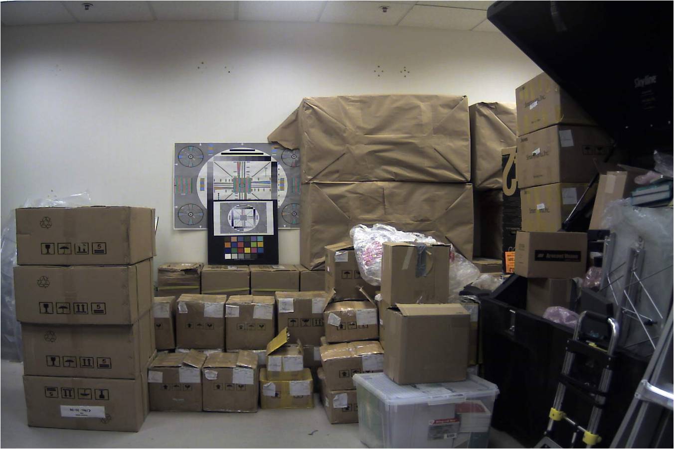

IQ color (IQ SENTINEL 852(IQ752))

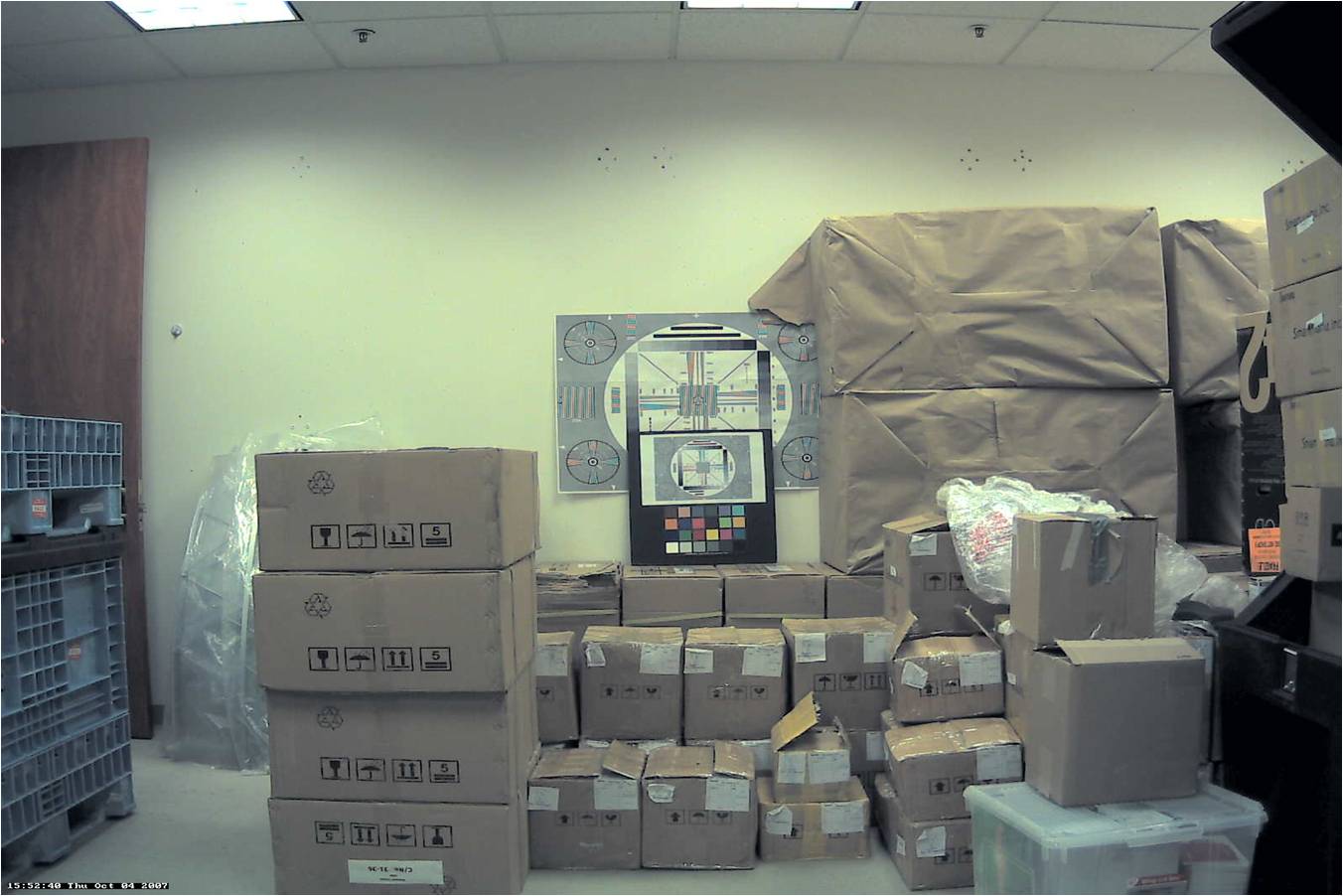

Arecont color AV2100DN

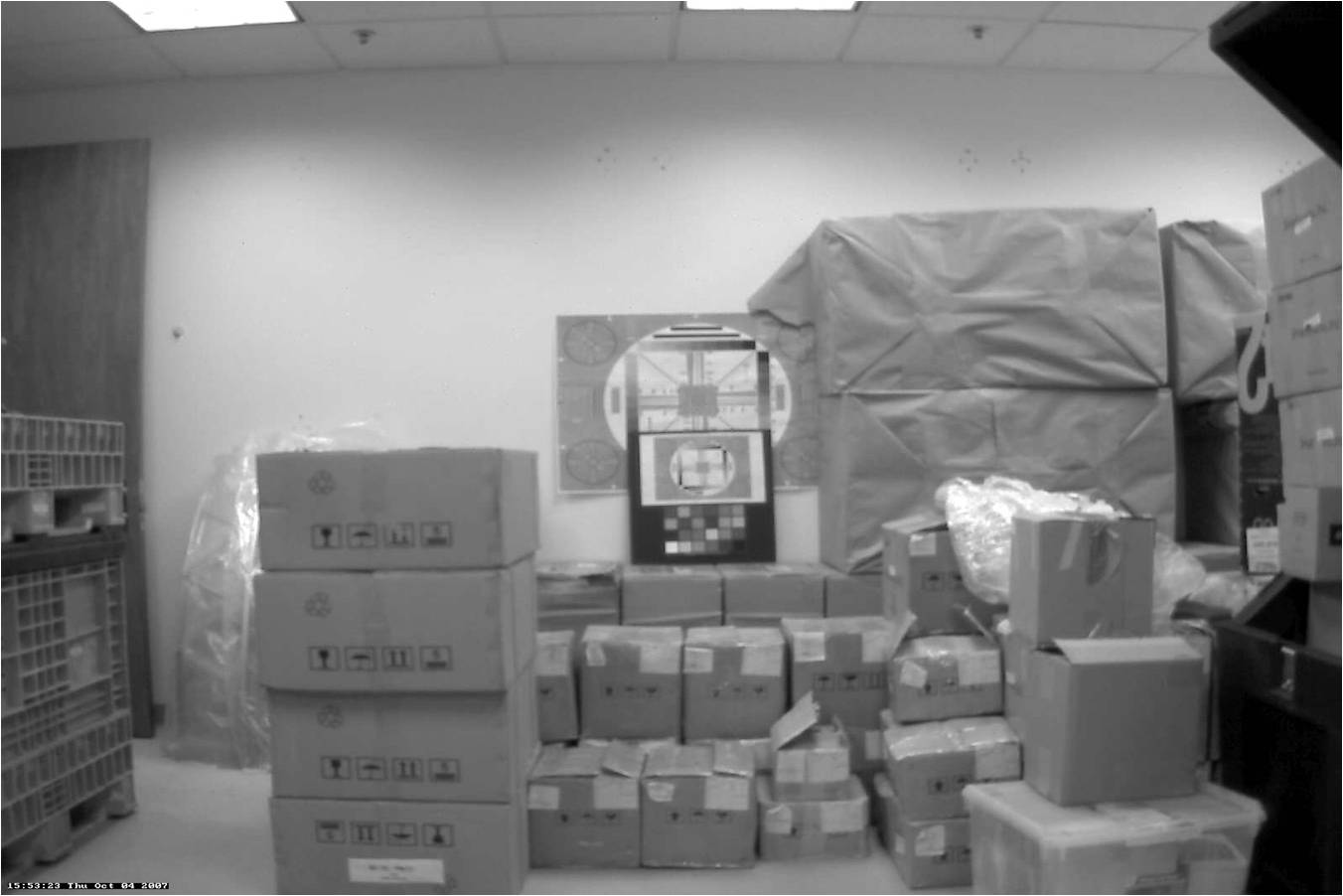

IQ B/W

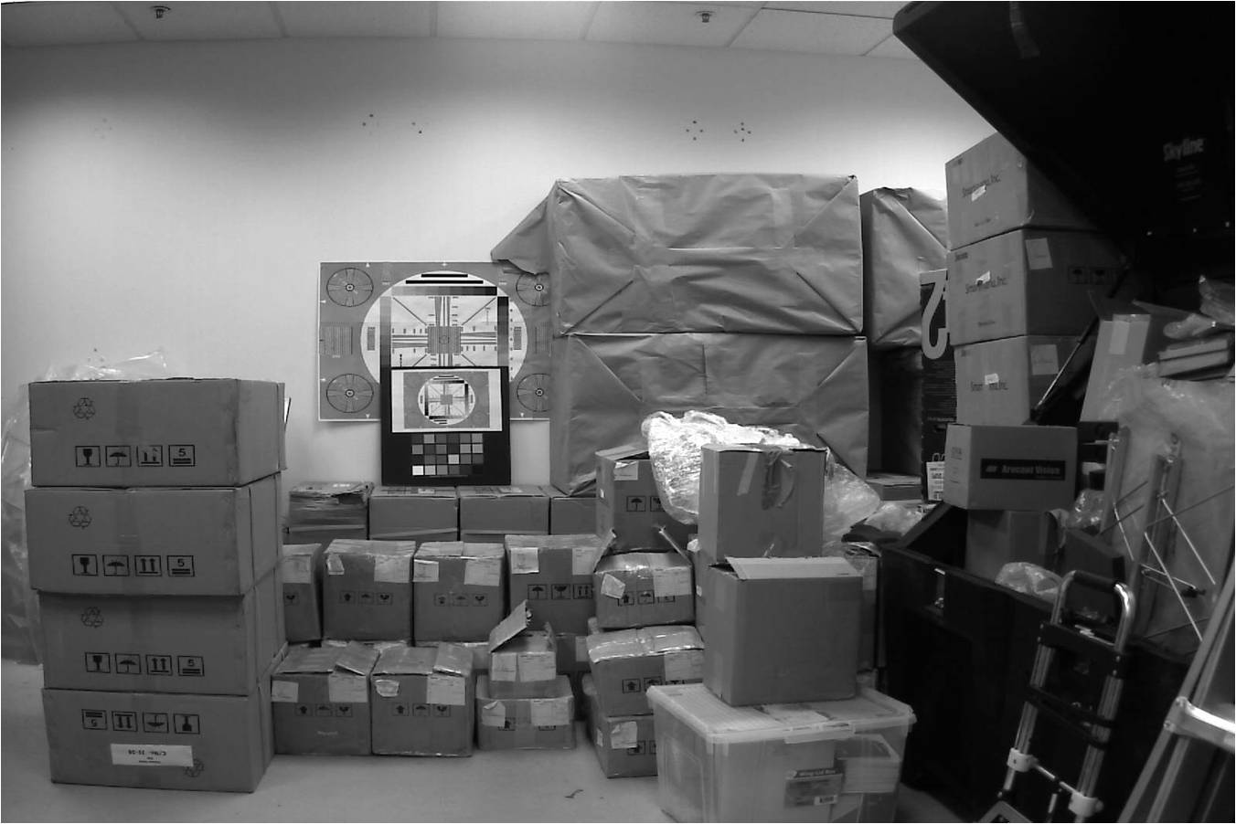

Arecont B/W

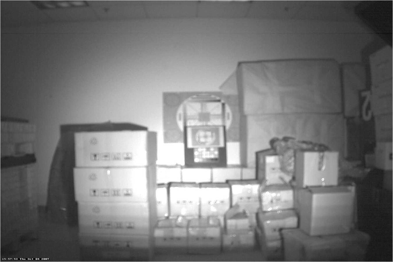

IQ B/W with IR

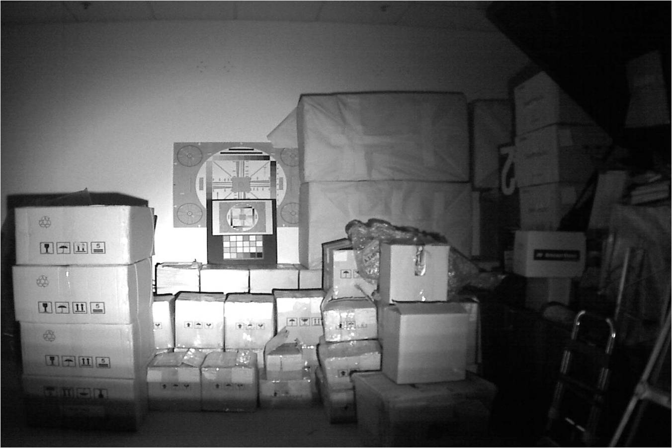

Arecont B/W with IR
Until IQinvision can show better images then this I am sticking with Arecont
The IQ BW and IR images are out of focus. Try focusing the IR and see if the color focus remains good enough.
Best,
Christopher
This seems more like a lens issue to me. Since IR is at a different wavelength than visible light there are always compromise when it comes to focusing. One generally picks what mode is used most and tries to get focus close as possible without sacrificing clarity by splitting the difference in focus. My suspicions are a better IR corrected lens on the IQ will yield better results between both mode. The Arecont definitely kicks butt here!
