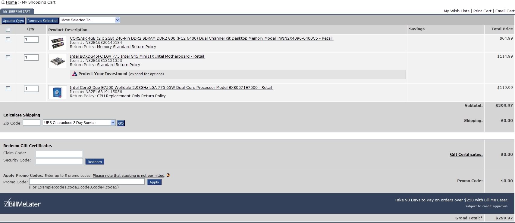

dopalgangr 0 Posted October 13, 2009 Yea, that was just for maximum power scenario Not bad though $300 and thats 4gb of ram Share this post Link to post Share on other sites

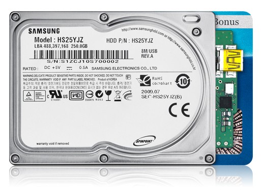

hardwired 0 Posted October 13, 2009 Just found this: Thinking it and a Mobotix cam might be a pretty good combo....Haven't found it selling anywhere yet, though. Share this post Link to post Share on other sites
thewireguys 3 Posted October 14, 2009 Just found this: Thinking it and a Mobotix cam might be a pretty good combo....Haven't found it selling anywhere yet, though. does that get power over the USB? Share this post Link to post Share on other sites
