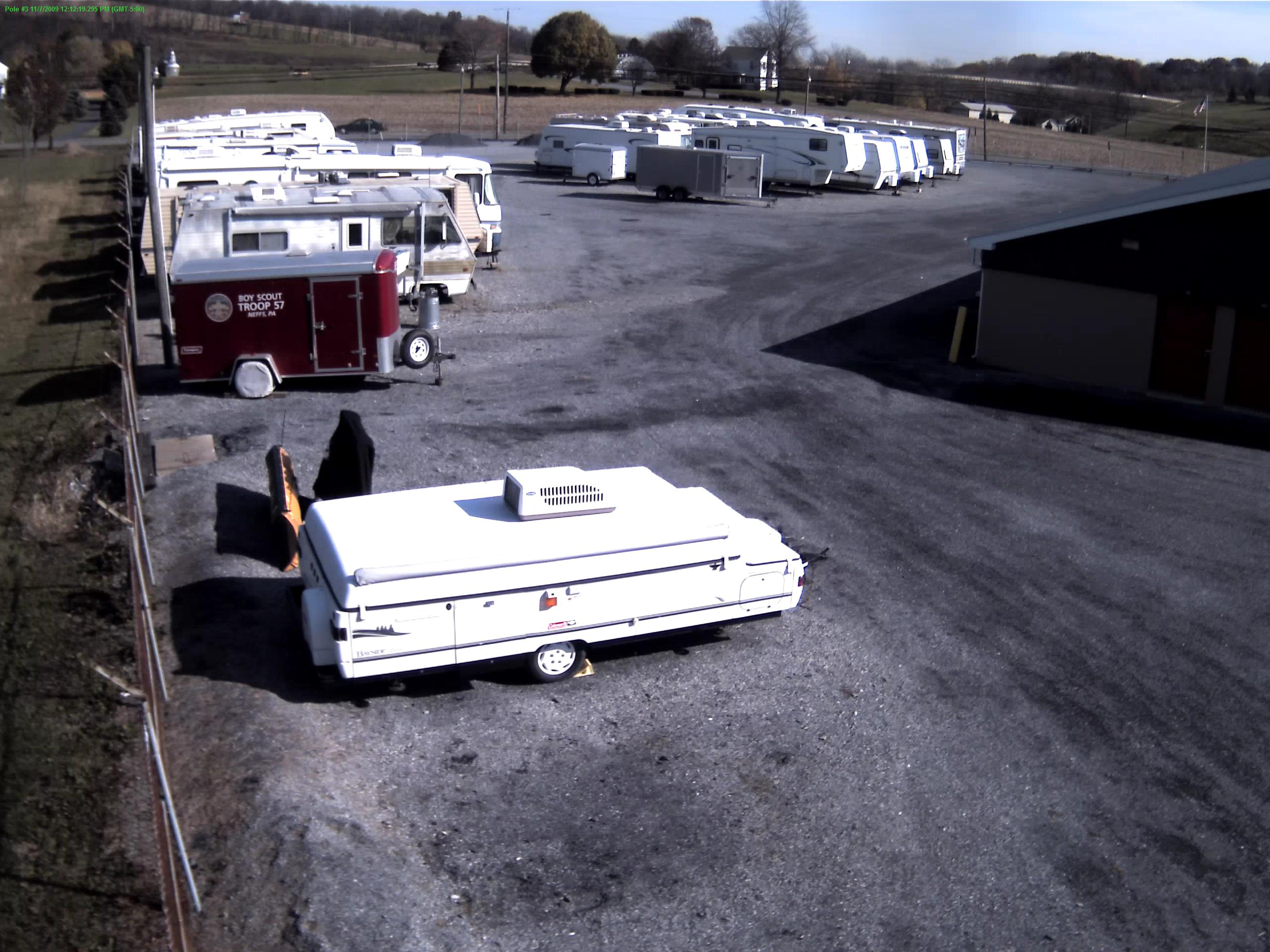

This a image from the AV5135DN it is the box style version of the camera you are looking at.

^^Focus seems a little soft in that 5135 pic...
Yea..... it's up on a pole so can't do much about it now till he adds more cameras and I have the lift again.
It is really hard to focus the camera with your laptop in your hand on the lift. You need to be in a dark room so you can see the image really well.

Agree on the focus in pic - say I needed to zoom on the boy scout troop truck, the little rectangle emblem far left it would not show and I seen IP 5MP able to achieve this. I would love the FOV of the pic above and be able to grab the little things on a zoom.
Any 5MP camera does not have the pixel density to see the emblem on that truck with the FOV that is setup.
