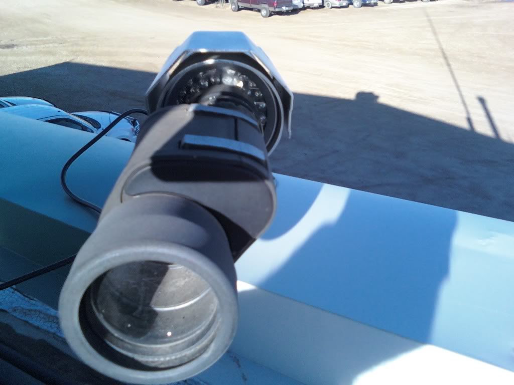

I have been doing a complete re installation at a site recently and came upon this rather unique setup. Apparently it worked at one time and maybe it's just me but it just doesn't seem like the type of setup I would recommend installing at a multi-million dollar facility.......
Anyone here ever try something like this?

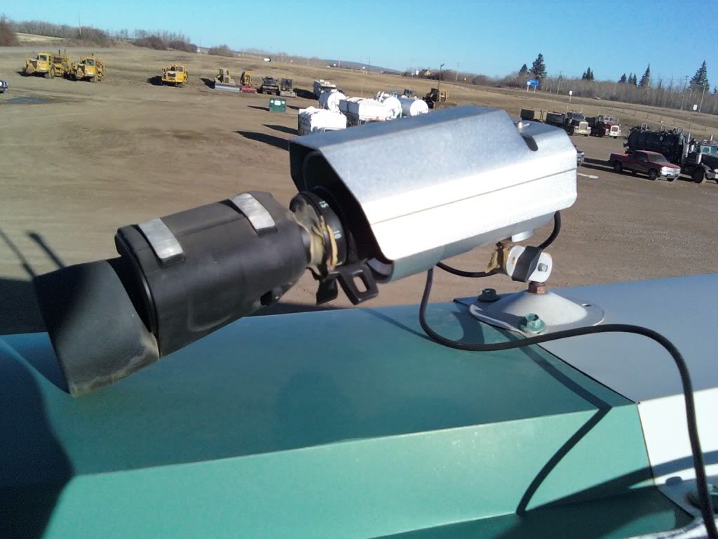

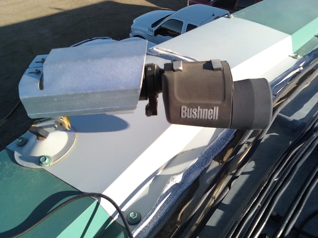

What on earth is it? Looks like an IR camera but those IR would be blocked by that ... lens??
It's actually a, well, HALF of a Bushnell binocular. The intention of the setup was to monitor the fuel tanks which can be seen in the background of the second picture. The original installer had some very unique ideas on pretty much everything for this 15 camera system. I even was electrocuted while fiddling with the BNC connectors at the DVR. And on the roof. It's been an interesting last few days.

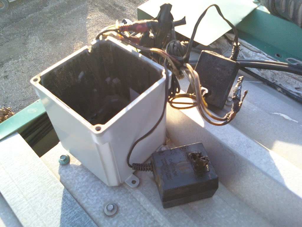

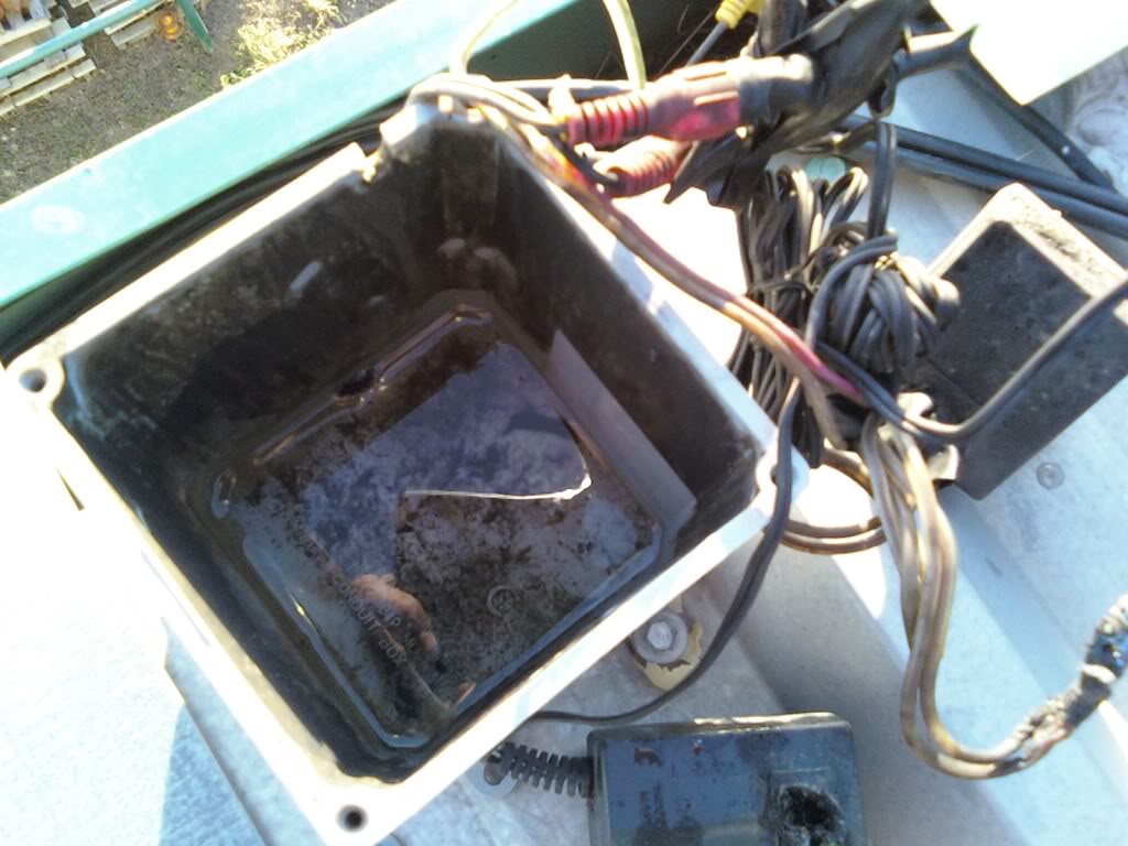

He ran 110V AC power up onto the steel roof using clear speaker wire to sealed junction boxes holding indoor use 12V DC transformers. Of course, the boxes were not sealed after a while of sitting out on that roof through temperatures of 30c to -45c weather and they leaked, shorted out the transformers. One even blew the prongs right off the transformer. I have managed to track down the AC wires to a few outlets, but it is a rather large building so locating the others will continue to be an enjoyable experience.

The camera worked! Sort of. It generated a kind of really low resolution B&W image before it would go gray screen. Also the image was reversed in that what was actually to the left showed up to the right. Out of 15 cameras 5 kind of work to different degrees of bad and really bad and one is acceptable. I asked if I could have the old camera as kind of a keepsake and possibly a donation if and when someone opens a Museum of Hillbilly Engineering, so I will remove it and take the thing home when I return with their new cameras in a couple of weeks. Now I will also have the perfect offering for those cheapskates who call me and want to know if I have any used cameras available.
Also, here are a couple of shots of the roof mounted and not-so-sealed-after-all conduit boxes with the indoor use transformers mentioned above:

lol looking at that no wonder you were getting shocked. And is that a huge pile of soldering with those 2 wires there?? :lol:
No soldering. That is fused/melted something or other, but not one of the prongs. I could not find them. Those yellowish/pink wires used to be clear speaker wires and are still live. They were taped to the prongs on the transformers. The installer didn't believe in connectors other than to put a splice in the RG-6 every 30-50 feet or so. - And he was using 1000' spools of the stuff. An electrician is coming to trace the live wires that I could not trace to their source. I found one that runs into the side of an electrical outlet box. I give the original installer a 9.5 for originality and a 0.5 for execution.
I nominate this for Worst Install Ever...
Not just for the level of some of the dumb stuff (120VAC speaker wire taped to transformer prongs? yo!), but the sheer scope of the stupidity, as from the sound of it, this extends to all cameras on the site. Juxtaposition plays in too - multi-million dollar site, you say??

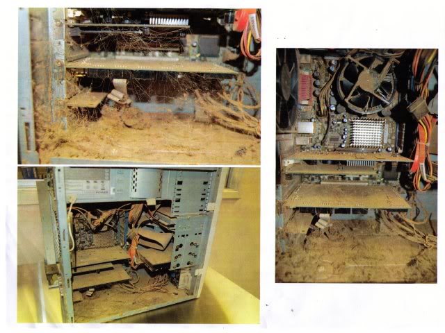

My supplier in New Orleans sent the following picture to me a while back when I first started on my nightmare repair. It is a DVR which was housed in a barn. Probably with the animals. Apparently it smells as bad as it looks.

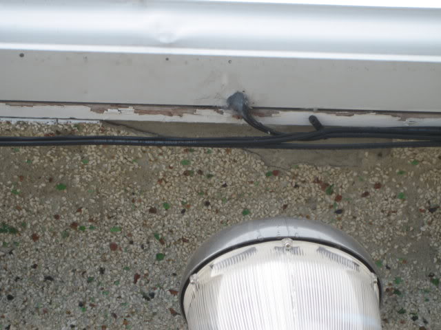

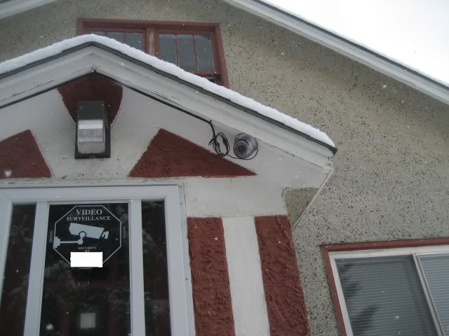

Oh! I just remembered I took some pictures from another repair I did for a customer. He had the system installed this summer and a connection failed to one of the cameras. The customer had the installer move a camera up on the house from the original position so he drilled a hole THROUGH the eaves trough, nearly hit the heat tape in the trough and then sealed it up with silicone. Of course, the trough began to leak water onto his outdoor light. The customer mentioned to the company that installed it that I was located nearby and that I would be able to repair the connection. That was great as far as they were concerned but it turned out they will not pay for the repair. I sent these photos to the surveillance company manager, never got a reply and when the customer went in to see what they were going to do he was told I have no idea what I'm talking about and that everything was fine. I included the shot of the front door in my email and politely explained that it looked pretty sloppy. Oh well, I guess I just don't know what I'm talking about......LOL
It's a pretty old house owned by retirees, but still no reason to make it look like that.
