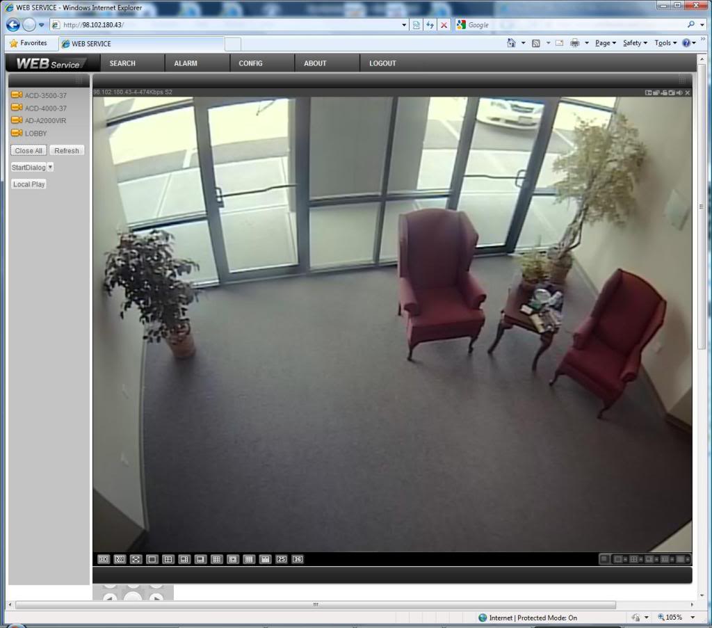

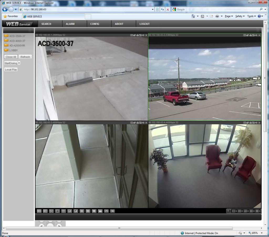

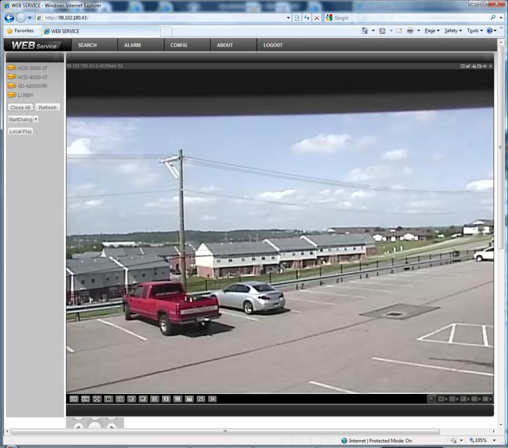

SpyGuy10 0 Posted May 14, 2010 Here are some images I captured from the Gen IV (Intellicam) live-feed demo of their G4-XLAHD: These are all from real-time streaming video feeds at CIF resolution, 30 fps. Click each image to see at the full resolution as captured on my PC. Unfortunately, no one was walking through their lobby at the time I captured these, but I have seen people in the feed in the past and you can recognize facial features, etc. I'm not suggesting that CIF is as good as 4CIF or D1; obviously it cannot be at only half the resolution. But as I said earlier, I was surpised at the clarity of these CIF images, even expanded to a single full-frame. And I believe these are the same quality as recorded because they would have to compress with H.264 to stream these feeds over the Internet. Rory, is this what you consider "blocky"? Or did you see something else on your demo? Share this post Link to post Share on other sites

rory 0 Posted May 15, 2010 Here are some images I captured from the Gen IV (Intellicam) live-feed demo of their G4-XLAHD: These are all from real-time streaming video feeds at CIF resolution, 30 fps. Click each image to see at the full resolution as captured on my PC. Are you 100% certain they are streaming the video at CIF? I dont mean the size of the video that you see, I mean the actual video. It could be 4 Cif but resized to smaller sizes, and heavily compressed. Additionally it could be D1 or 4 cif but have bandwidth and bitrates set to much lower, and be compressed more with their H.264 for faster video. Thats not the CIF you get on the recorded video anyway, which is my main concern. It doesnt look too bad though, but it is still rather blurry. Unfortunately, no one was walking through their lobby at the time I captured these, but I have seen people in the feed in the past and you can recognize facial features, etc. I'm not suggesting that CIF is as good as 4CIF or D1; obviously it cannot be at only half the resolution. But as I said earlier, I was surpised at the clarity of these CIF images, even expanded to a single full-frame. And I believe these are the same quality as recorded because they would have to compress with H.264 to stream these feeds over the Internet. Rory, is this what you consider "blocky"? Or did you see something else on your demo? Blocky is what the recorded CIF video was, remember, I never tested the remote video. Whether the Recorded CIF video is as bad on their advanced unit or not, unsure as I guess I had the middle of the line one, and before HDMI, but it was bad on the slim line one which was the latest, BUT is the budget one. Now when i say bad, yes you can see people, inside .. but every little detail counts. In that case though it was also very blocky, nothing like in the remote video demo above. Recorded video is the most important part of a DVR, for evidence sharing. Unfortunately the person that bought them for us to test chose not to spend anymore on those right now, to test the newer HDMI unit, as really in past experience there has never been that much of a difference between one or the next, and remember we did test the slimline HDMI unit. Hence he will spend the money right now to test the Hikvision standalone, and one of their cards .. I would be ever greatful if you could to bite the bullet and get one of the Intellicam 16 channel non slim lines .. with HDMI .. their best one .. I mean bottom line is you cant go wrong .. and test it for us ... but also for yourself .. but we are mainly testing units to resell down here and the cost on their most advanced unit is way too much anyway, after 35-45% Customs Duty, but would have been nice to see it anyway. Share this post Link to post Share on other sites
