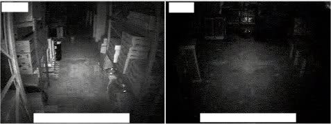

a basic example of cheap Color IR Turret Domes, this was in a warehouse for example, notice the difference of IR from one narrow isle to a much wider isle with no objects within its IR range for it to really reflect off of. These were okay cameras for the price, low res and the color is fine indoors at least, but cant point them at a door entrance during the day or everything is dark, terrible backlighting, no idea how they would handle night club or bar lights.

And this is what a really crappy Color IR camera may end up looking like.
some no name camera .. no idea where it came from but its a color IR bullet.
