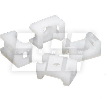

Quick test: snip all the zaps strapping the cable to the conduit... this should allow it to sag away from the 480V line. See if that doesn't clear up the problem right there. Then you can go back and either re-route it along some lower-voltage (120V) stuff, or to the girders, or use some cable saddles or something to attach it right to the bottom of the Q-deck, away from the 480V.
