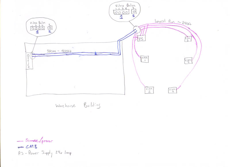

MasterVision_Tech 0 Posted September 4, 2010 Hey everyone, Thanks for taking the time to read this and help me figure this out. I just wanted some other opinions on what the problem might be, so don't be afraid to speak up ! Project: 5 Parking Lot Camera Cams : Eclipse ECL-640 Power: 24V Power Supply 1 AMP Wiring - Video Balun (passive) (One 4 port and One single) using CAT5 for about 300'-350' --> Then to RG59. Longest run on RG59 is about 300' additional feet. Power is being run over the RG59 so longest run there is also 300' to camera. Problem: When I go inside to look at the DVR feed, I show faint lines running across the screen. It shows this way for four cameras. If I add the fifth camera line in, the picture gets very distorted (mostly likely because of an improper wiring job but another tech ran the line). 120V had to be supplied to the site and the electricans came out to do the job. I can tell you that the power board for the cameras, has not been grounded. I have a feeling that that would make a difference on a AC setup, but there was no where to ground the wire onto the board. When I make my return trip, that was one of the things I was going to try to see if that would fix the problem. The cameras are mounted to fiberglass poles (I can be sure of this because most of the dust particles are still in my arms) using a pole mount kit and metal screws. I guess what I am asking is: Do you believe that the power box should be ground and do you think that is the issue ? Where would you mount it ? Personally, I do not believe that it is the baluns. Four cameras are running on one line and the last camera is running on the second line. I have been reading about the ground loop effect, but I don't see where else I could be getting the problem except maybe at the power box. I don't believe that the camera mounts or locations is fault either. Like I was saying before, I'm usually a DC person but the runs were to long for me to run DC. Let me know what you think Share this post Link to post Share on other sites
Soundy 1 Posted September 4, 2010 Your description of the problem SOUNDS like a ground loop problem... can you provide some screenshots of the interference, both with and without the fifth camera? If I follow the description, you have Cat5 from each camera back to a balun, then coax from there back to the DVR? Power is running via coax to the baluns, then splitting out and running over the Cat5 to each camera? Or one Cat5 from the DVR to the four-port balun, then coax from there to the camera? Silly question, but I assume you have baluns at both ends of the Cat5 runs? Share this post Link to post Share on other sites

jeromephone 6 Posted September 4, 2010 I am a bit confused as to why you would run this combo of cable. If you run cat5 with baluns and a seperate power wire it should make things simpler. We try to look a job and think about how are we going to trubleshoot this in three years. A different tech goes to the site should not have to spend time figuring out what the heck these four kinds of wire are. We tend to overkill the power wire a bit and I like isolated power supplies when possible. I also figure if we are going to warrentee this install I don't want to go back and redo stuff with the costs coming out of my pocket. Share this post Link to post Share on other sites
rory 0 Posted September 4, 2010 The layout you have is a little wrong. I try to explain it better....sorry. From the camera, the video is connected using siamese cable down the line to the power supply and video balun (max distance from camera to power supply and balun equipment about 275' - 300'). The power supply and video balun are in seperate units. Video is being transmitted back inside the warehouse and to the office using CAT5. Video balun are at both ends of the CAT5 cable. I would say the distance on the CAT5 is around 300' - 400' feet also. I am using two CAT5 cables to send the signal back from the cameras. One of the CAT5 cables is sending the signal back for four of the cameras, and the second CAT5 is being used to send the video back for one of the cameras. All cameras are showing the distortion. Video baluns at both ends. Did you try one camera connected at a time on the DVR? And one camera powered up at a time? Also going by the specs of that camera it is 12VDC @ 850mA? You say you are using a 24VAC power supply? 12VDC probably wont make that long run either. Share this post Link to post Share on other sites

tomcctv 187 Posted September 5, 2010 Hi.mastervision. looking at your pic. you have all cameras going to a power supply which you have listed as 24v 1 amp. if that is the case then you have no chance running all 5 cameras off that. you will need that for each camera. the cameras you have listed are 950ma with ir. Share this post Link to post Share on other sites
MasterVision_Tech 0 Posted September 5, 2010 Hi.mastervision. looking at your pic. you have all cameras going to a power supply which you have listed as 24v 1 amp. if that is the case then you have no chance running all 5 cameras off that. you will need that for each camera. the cameras you have listed are 950ma with ir. My mistake... 8 OUTPUT 24VAC 4.2AMP Share this post Link to post Share on other sites

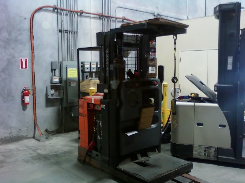

MasterVision_Tech 0 Posted September 5, 2010 that power supply isn't big enough! you're maxing it out. That's a problem, but I don't think its THE problem. I still think its the cameras. Think so? When I look at the video feed at the cameras, I don't see the distortion. The only other thing that comes to mind is that when I was at the site yesterday, I noticed that one of my techs ran the CAT5 line right next to a 480v conduit.... The conduit runs to a 480v sub panel that they use for their forklift chargers..idk may have something there. I forgot who asked or suggested, but there is no grounding for the DVR plug and the cameras are mounted to fiberglass poles so I don't believe that there would be any interference there... Share this post Link to post Share on other sites

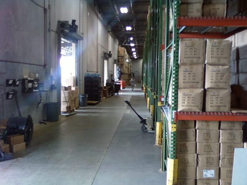

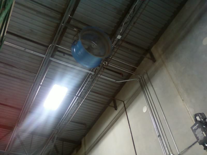

Harrar 0 Posted September 5, 2010 The only other thing that comes to mind is that when I was at the site yesterday, I noticed that one of my techs ran the CAT5 line right next to a 480v conduit.... The conduit runs to a 480v sub panel that they use for their forklift chargers..idk may have something there. If the CAT5 is running parallel along the 480 volt line you may have found a good cause for your distortion problems. Share this post Link to post Share on other sites
bpzle 0 Posted September 5, 2010 Definetley! That's a very big no-no! Share this post Link to post Share on other sites
Soundy 1 Posted September 5, 2010 that power supply isn't big enough! you're maxing it out. If that current rating on the cameras is 950mA @ 12VDC, it's going to be only half that at 24V. The only other thing that comes to mind is that when I was at the site yesterday, I noticed that one of my techs ran the CAT5 line right next to a 480v conduit.... Yeah, I'm thinking that'll do it, too... CROSSING or PASSING near a line like that wouldn't be a problem, especially the way the balanced line inherently rejects noise, but running it anywhere close to the line for any substantial distance will induce HUGE amounts of noise. I bet if you watch the cameras, you'll see they get worse as they plug in more forklifts to charge, too, as the current draw on the 480V line will get higher and thus create stronger fields around the conduit. Of course, it could just be the cameras, too I am a bit confused as to why you would run this combo of cable. Actually, I've done similar in just such a situation as well. You might do it if you couldn't get a large number of coax drops from one point to another - you can easily get two Cat5 through 1/2" EMT, whereas you wouldn't get 5+ RG59 through even 3/4" EMT (especially not if there's more than one or two bends, and not without LOTS of lube). You might do it if the Cat5 was already in place, too. Nothing wrong with this sort of topology. Share this post Link to post Share on other sites
