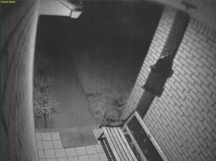

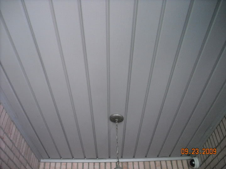

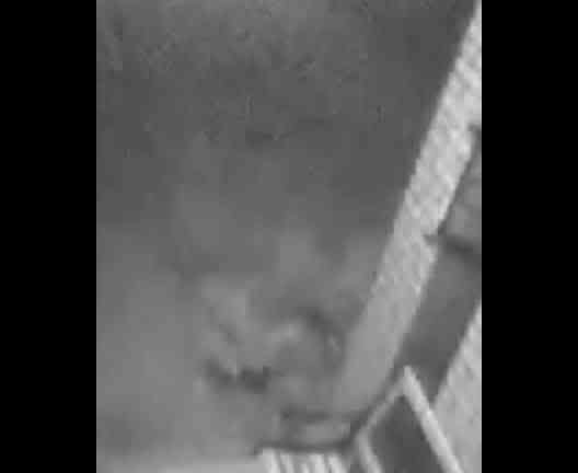

A single illuminator mounted on this porch ceiling (about halfway between that light fixture and the edge of the roof) nicely illuminates that porch at night:
I have a number of those deployed, and have had only one malfunction. Same scene as above... I took video through the DVR, and through some night-vision goggles:

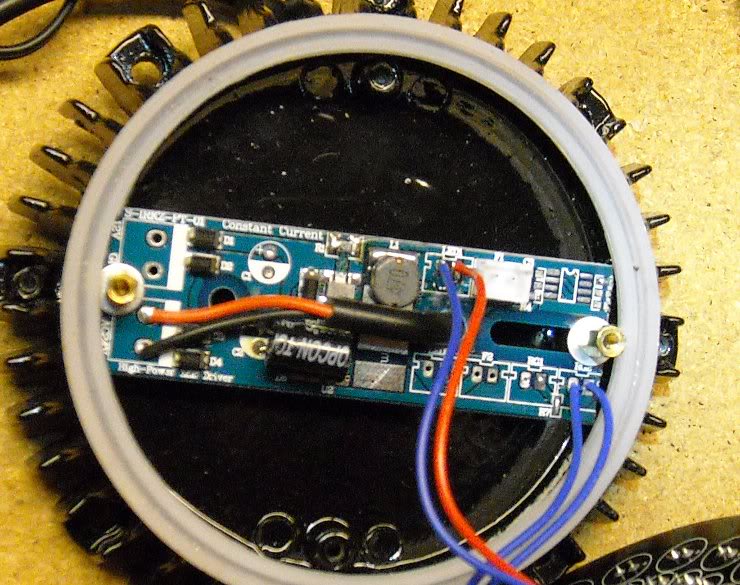

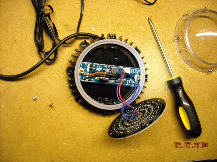

Taking that illuminator apart revealed a very simple circuit board behind the LED array:
Here's a close-up:
The problem ended up being that capacitor (good ole' Capacitor Plague). After changing it out with a soldering iron, the illuminator functioned flawlessly once again.

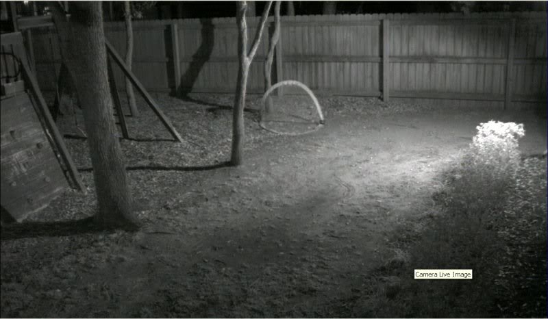

Here is what one of those dome illuminators can do when mounted up on a wall. There's a wall that runs right along the right edge of this frame, and the illuminator is mounted about 7ft up the wall, facing horizontally.
Camera is a Mobotix D12, with a night imager (N43 IIRC)

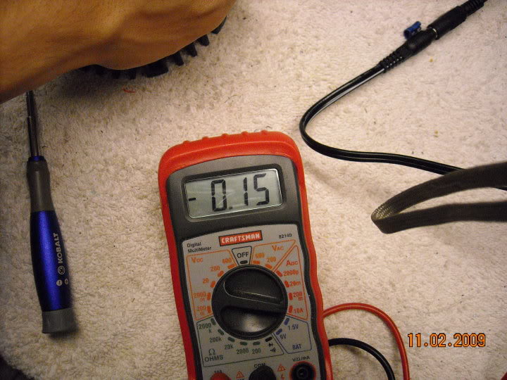

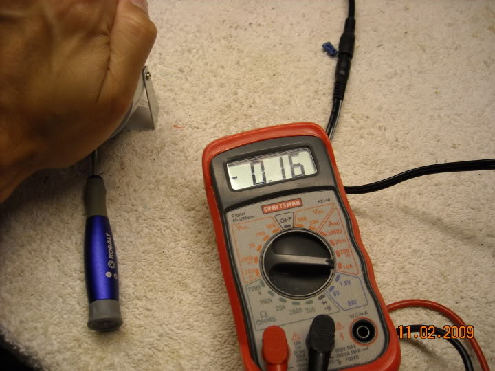

BTW, I found the round 48-LED Ebay unit only pulled about 160mA:
The Dome illuminator pulls even less current... 150mA:

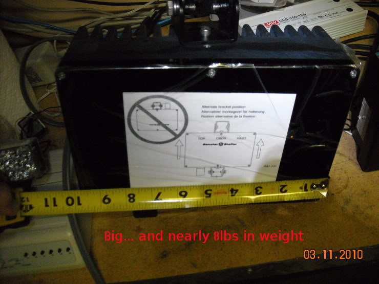

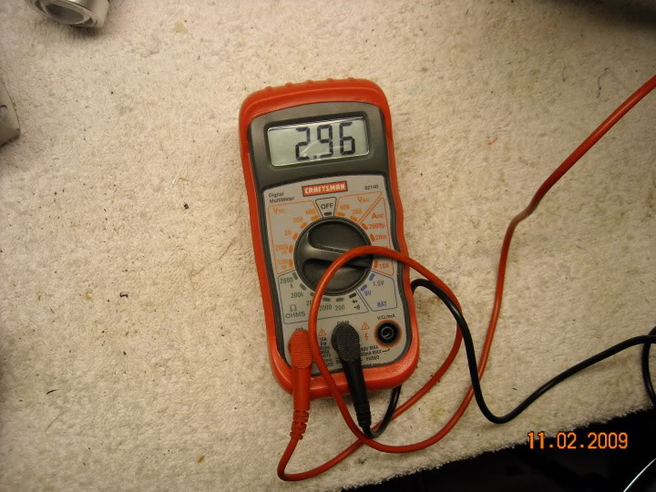

Compare that to a big panel illuminator... this one is made by American Dynamics:
It pulls almost 3A... gets pretty warm too.

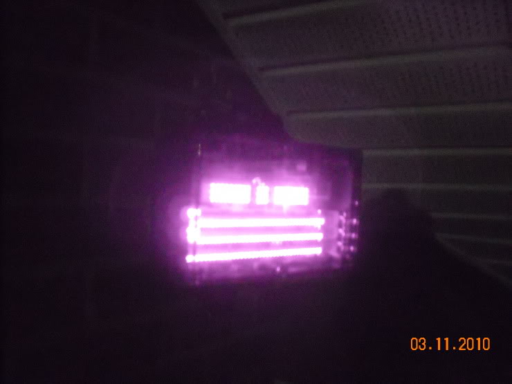

Some of the big panels are great... I have one mounted on the front of the house... throws a pretty long pool of IR:
This one is a Senstar panel:
Very nice. Do you happen to know what shutter speed that is at?
Hang on... let me check the settings.
*********** Edit ***********
Max exposure is 1/5 second. Want to see it with a faster shutter speed?
