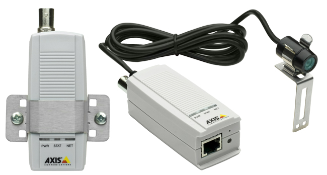

tomcctv 188 Posted February 22, 2011 There is soooo much junk on ebay, I won't even go there unless I know what I am looking for (and there is still the risk is it fake). What I am looking for is a camera I can incorporate into an outdoor mount on a light pole or stone/brick "monument" acting as a light pole. I can create a pretty decent protected zone inside so the only thing that would be exposed would be the lens, so I am looking for something that can handle that sort of exposure and is decent. Most searches I do end up with a lot of ebay junk, and I don't see much from the big CCTV camera outfits. Does anyone have suggestions for sources of GOOD quality cameras that are small enough to hide? I'm willing to go to some effort to do the hiding, so it doesn't need to be Mission Impossible, but I'm more concerned with finding quality in a small package. I could go IP or analog. MP would be a plus, but I'm not optimistic that can be found in this package. Thanks for your time! -Dave axis do a good little covert camera set-up AXIS M7001 Covert Surveillance Kit Share this post Link to post Share on other sites
