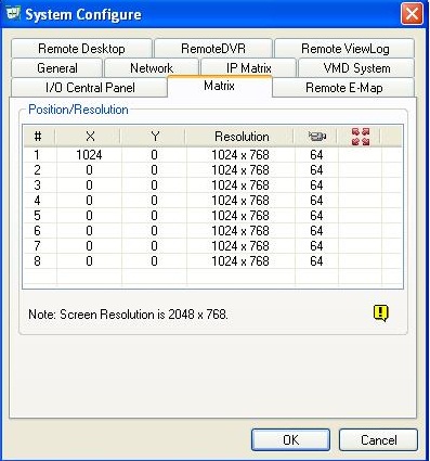

ssmith10pn 0 Posted February 28, 2011 It's pretty slick how it works. Once Windows knows the monitor is there so does Control Center. You build your Matrix screens and name them lets say Matrix 1 and Matrix 2. Lets say your monitors are in 1024 x 768 Matrix 1 would be left alone and Matrix 2 would have a cordnate of +1024. I'll do some screen shots for you today. Share this post Link to post Share on other sites

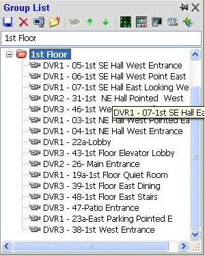

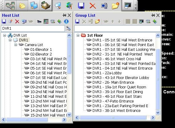

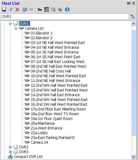

ssmith10pn 0 Posted March 1, 2011 The host list. This is where you import your DVRs into control center. This setup has three DVRs. The group list. This would be your first group of cameras from assorted DVRs to create a Matrix from. You drag cameras from the host list into here. Host and group side by side. This is where you set up the location of the Matrix. This particular has dual monitors with only a matrix on monitor 2. Two 1024 x 768 monitors is 2048 x 768. By making the X dimension 1024 that tells the matrix to start on the 1025th pixel. The Y axis would be if you have monitors stacked. Share this post Link to post Share on other sites
