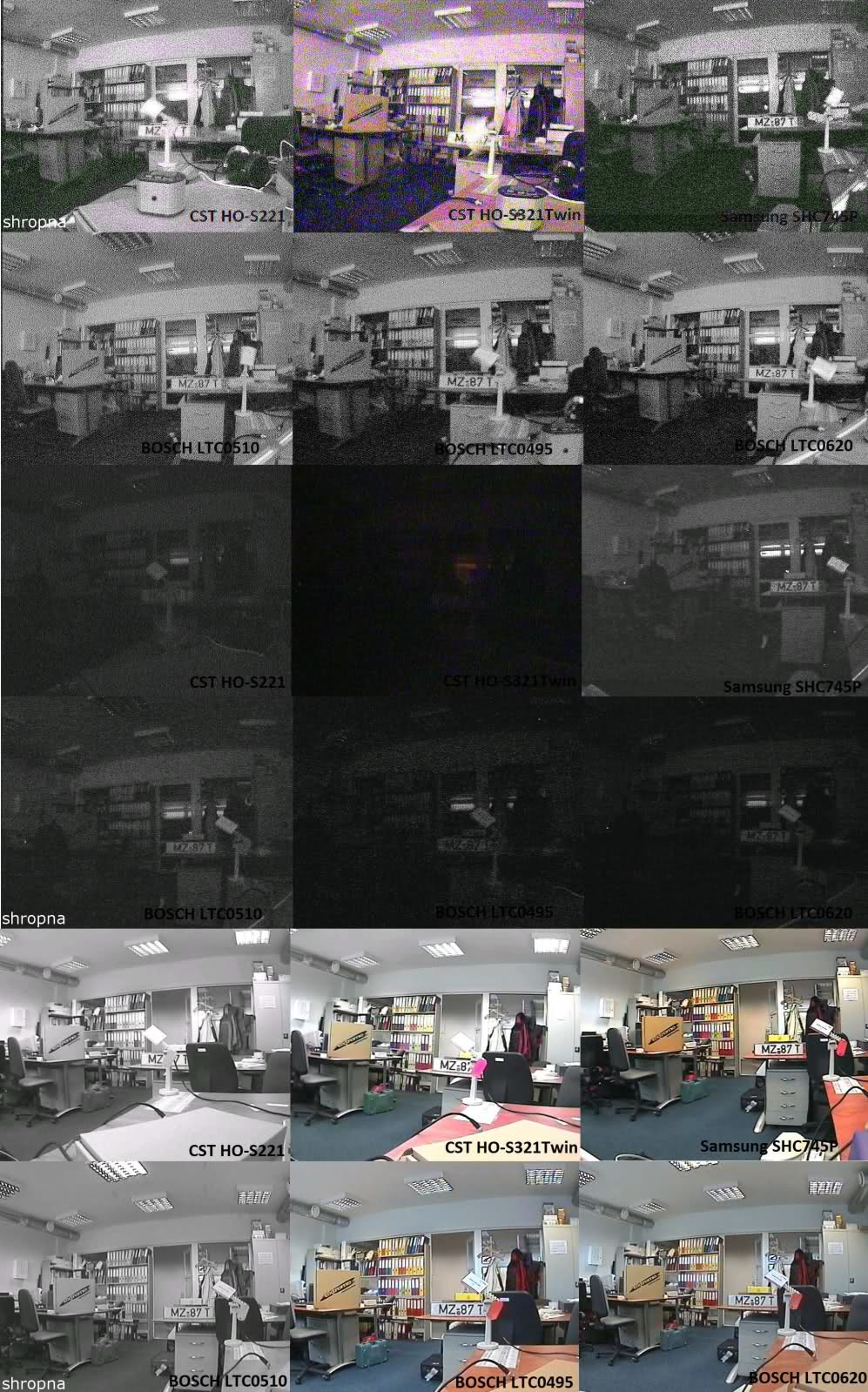

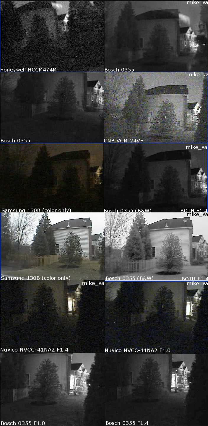

if someone has time, if they can get all the threads with comparisons in them or even samples, useful ones so nothing from years ago (like many of mine LOL), then I can make it a sticky. My hands are tied right now with work so dont know if I have the time ... maybe though .. anyway
Hmmm... Maybe I'll take some time today to save a bunch of comparison pictures, and put text on them that shows what camera they are, who took the picture, and other details like whether they used an IR light, etc.
Would that be OK? I don't want to go grabbing everyones pictures if they aren't OK with it.
This may take a while...
How about like this?
Thats a great start
Though Im surprised there arent people asking for their original sizes
Thats a great start
