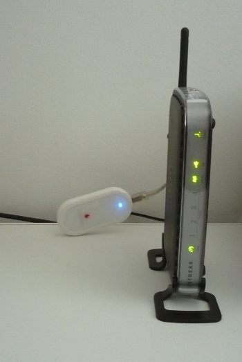

yes thats all you need. saves having to use a laptop or pc. you just use a netgear router 3g to put your dvr on the net.
thanks for the pic. So I guess I need a router?

get router, connect dvr to router, connect USB device to router and voila! i would be able to remote view through router?
i guess i would also need a USB to ethernet adapter to connect the USB device as the uplink for the router?
There are specific routers made that accept a 3g/4g USB modem plugged directly into them (some are the ones I mentioned above, plus other brands are available). Then, all configuration for adding a DVR/NVR after that is similar to any other broadband setup with a router.
