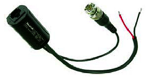

You could also use something like this to keep everything clean.
http://www.muxlab.com/products/ve_cctv_power_thru_balun.htm
Thats actually what we used at one job. My boss had just asked me this mourning about running the power and video down UTP without buying a balun like that because they cost more then a regular balun. I agree and think its allot cleaner to use the balun you linked to. I was just looking for some input to relay to him about it. In my opinion for a short distance it wouldn't be bad but for long distances it might be a better idea to just buy the poe balun.
