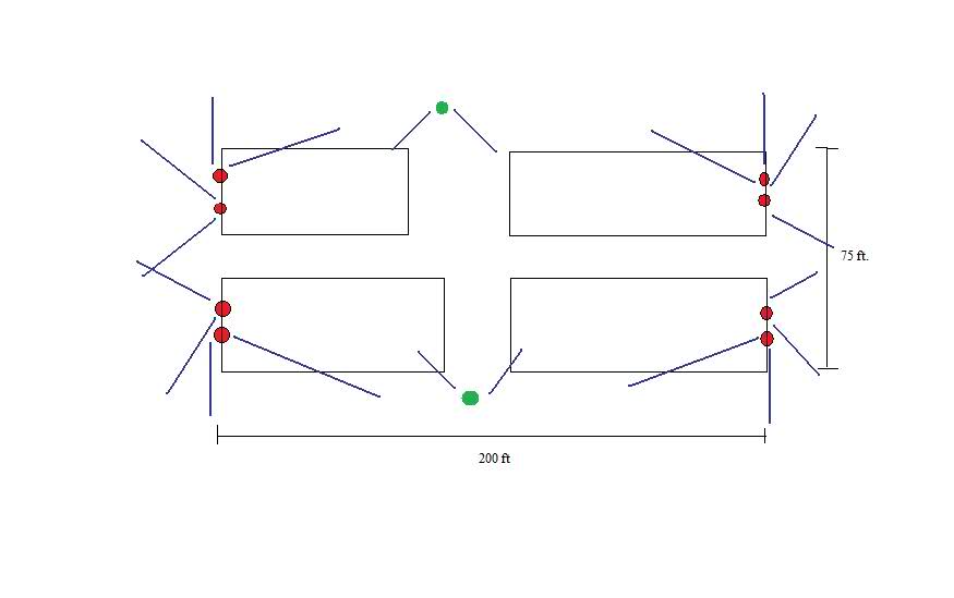

You can have your beams hardwired to your cctv system. If you are going with beams I would do an in depth comparison of IP vs Analog cctv.
At this point i am not certain that PTZ's are the way to go ---- was just a comment on how effective a PTZ is for the investigative function of cctv. (Every detection device, including beams will give false positives)
You see as soon as you mention PTZ then you have a flurry of marketers trying to sell you this or that brand or technology. BUT ---- nobody has asked you yet if you need to record anything.
So some further questions:
- the target you wish to observe is i gather limited to people?
- The activity that would concern you is people crossing the perimeter line.
(A lot of simple analog cctv systems can provide you with perimeter line analytics....thats an invisible line doing exactly what those beams are going to be doing - Analytics though not really a mature, technology at this point unless you go with really expensive dedicated systems)
Do you need to know immediately they cross the perimeter, or are there what we would call "pinch points" (Points that a target would have to pass through in order to get to areas of vulnerability?)
When people cross your perimeter line they can be pretty innovative, they walk upright , they crawl, they do many things.
- The reason you need to detect this breach is to................? Alert armed guards? Activate a facility alert?? To investigate the breach is not the reason you need to detect....investigating it aids in achieving the purpose. So you have to include into your design parameters - what you actually intend doing - once you have confirmed that somebody has crossed the perimeter - some may disagree, but the actions you will need to perform once confirmation is attained, is going to have a significant impact on the type of system or technology you ultimately choose>
Now once you have determined whether you need visual verification and established what you want to do with that visual verification, or what action must follow out of viewing the image --- that is going to define the level of surveillance you need -- monitor, detect, recognize ---etc. If is just purely monitoring level surveillance, all these expensive hi tech high definition surveillance cameras are just wasting your money.
There is so much more to this that I couldn't possibly run through it all on this forum - I would suggest you get hold of a professional security company ----- not a CCTV guy. Somebody who is going to want to understand what other security systems you already have on the premises, how the solutions they propose will interact with existing systems, and asks similar questions to what I have been asking.
Please - avoid at all costs , those guys that ask you where you want to put a camera and then start telling you , you need this camera or that ---- the biggest indicator of caution, is when they start popping brand names - usually you are going to have a branded solution force fitted to your problem.
Does it sound like overkill? Well unless you actually succeed in reducing or limiting whatever it is that has been happening to move you to consider monitoring your perimeter - any system or device you install was a complete waste of money. isn't the investment in the time required to do it properly the first time - a lot less expensive.
PS ----- If you ask a specific performance question such as are there beams that do so and so, a response such as product x has this spec would not be out of place

Hey guys, I'm trying to setup an 8 camera system to cover the outside perimeter of a
200 x 75 foot land area.
I drew a little picture to try to give the general idea. The green cameras are the optional ones
Ideally we will have 8 cameras to save costs, but a 10 camera system would be better.
The cameras must be: We were thinking of going with dome cameras.
- Vandal Proof
- Have decent nightvision (there are lights on at night. About 200 watts for every 2 cameras)
- Motion detection
I've been doing some research, seems that a 2.8mm lens will give an 81 degree field of vision, which is not enough to fully cover the area with 8 cameras. Can someone recommend a camera with a wider field of vision, if they exist?
These will be in Candian winter where conditions are in the -20C sometimes. Will I need a heater for the cameras for the cold winters?
Questions:
- What is the range of motion detection? I'm guessing it depends on the camera, but on average.
- The max wiring will be about 200 feet. I am undecided if it will be easier to use RG59 with 18/2 wire or cat 5 cable (using 3 for power and 1 for video, or whatever is better).
And the main questions:
- Is it possible to do this without any professional help?
- Can anyone recommend any sites to buy equipment and ship to Canada?
I know I have a lot of questions and I appreciate all answers.
Thank you all.

you do have a good budget for doing the install yourself. but i would use some better cameras than what you have listed to atleast get some identifacation be it person or car.
like the wireguys have said :::
VideoIQ is the real deal. PTZs have moving parts that can fail and most PTZ only have a 6 month warranty.
You can detect people cars and boats day or night 24/7 (with IR or white light) with minimum false positives. You can trigger events or alerts based off rules. If you just want to receive and email only when 2 people are on your lot for more then 5 seconds you can do that.
http://www.youtube.com/watch?v=A1RdBtHcaGw

or you could also look at hybrid systems mix and match or standard and ip cameras using the ip for more detail in your needed areas
http://www.aver.com/Surveillance/Product/Detail.aspx?id=263
https://www.exacq.com/products/hybridservers.html
By the time you buy the beams and run all the cables for control and power and get them installed VideoIQ will be cheaper and a better solution.
CCTV doesnt replace a burglar alarm, plus beams are not expensive, alarm systems are peanuts compared to CCTV.
