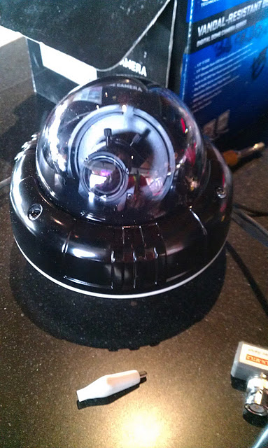

Soundy 1 Posted September 19, 2011 Need help in choosing a CCTV for a small 3-story hotel (70 rooms). I will need about 8 interior cameras and about 4 exterior cameras. Looks like "dome" cameras is where I would need to look, correct? Looking for a reliable system but not too expensive. Read good stuff about "CNB"? I'm a fan of dome cameras in most instances, and CNB does make some decent ones, and some very good ones. Look for the models with the Monalisa chipset - particularly, the VCM- and VBM-24VF are excellent vandal-resistant domes for their price range; look at the DBM-24VF for an indoor dome. I will be doing the install myself. The floors have drop ceilings so wiring should not be too hard to do. You'd generally think so, wouldn't you? I'd recommend using Cat5e for the wiring, along with baluns to connect to the camera and DVR, rather than coax cable with separate power. It will be cheaper in cable costs, and just less hassle on the whole. For the 8 indoor cameras you can either us Body cameras or dome cameras. For the 4 outside cameras i would recommend IR Dome cameras as you will need the Infra-red to see at night (start from around £80). I would suggest not cheaping out on this. You're not protecting your home, you're protecting your business. Built-in IR in cameras, especially in cheap ones, is usually done as a work-around for a camera that has poor low-light performance. Save the hassle and just get a camera that does well in low light to begin with. Around a hotel, you're probably going to have plenty of light anyway (liability concerns - can't have it so dark that customers are tripping over things), and the Monalisa models work great with very little light. You also need to consider that as you have a drop down ceiling, can the cameras be reach by a person to disable? If they are reachable then I highly recommend that you get a Vandal-proof camera. If they can reach the camera, they can probably just yank down the whole tile. Consider vandal domes for these, but don't get too hung up on it if there's a good cost savings in going non-vandal. BTW, the proper term is "vandal RESISTANT". There's no such thing as vandal PROOF. You will be using 12 cameras in total, your best bet would be to purchase a 16 Channel DVR as in the future if you wish to purchase further cameras then you just need to buy the cameras. 16 Channel DVRs start from around £260 and can go up to £700 depends on the quality, hard drive size and features. 16 channel DVRs can go up to thousands of dollars (or quid). Given that you get what you pay for, consider what a low-grade toy you'll be getting for £260. Share this post Link to post Share on other sites

Soundy 1 Posted September 22, 2011 If I understand this correctly, you would run cat5 from the baluns to each of the cameras, and then from the baluns to the DVR you would run coax? That depends on the balun and its specific design. Think of a balun as a "twisted pair to BNC adapter" - there are different styles that can be connected in different ways. For example, this is this is the most common style (two terminals on one side, male BNC on the other side) that you can connect directly to a camera and DVR: For example, here's one way you could do this, with four cameras on one floor: - Pull a Cat5 run from the phone closet on that floor, to each of your camera locations. - Use one of the above baluns on the camera, with one pair of the Cat5 (I normally use the blue pair). - Split out two pairs of wire for power (I normally use orange and green) - Put the power supply(ies) for your cameras in that phone closet as well - Connect the power pairs for each camera to the power supply(ies) - Pull one Cat5 run from that phone closet to your DVR location - Connect each pair of that run to the video (blue) pair of each camera run - At the DVR end, just put one of each of the above baluns on each pair, and connect directly to the DVR. Now that's just one option... again, there are lots of others, depending on the designs used. Here's a unit I've recently discovered: http://www.easterncctv.com/accessories/ev04p-vps.htm The nice thing with this unit is that it has baluns and power supply in one, so you don't need a separate power supply for the cameras. With this, you'd simply terminate each Cat5e run with an RJ45 plug, and plug it into the appropriate channel. The "4 in 1" port would be for your run down to the DVR. Then at the camera, you'd use one of these: http://www.easterncctv.com/accessories/ev01p-vp-t.htm Finally, at the DVR end, you'd use one of these: http://www.easterncctv.com/accessories/ev04p.htm - along with a set of short Cat5e patch cords to connect to the DVR. You could also go with eight-channel versions of the above units, for more than four cameras, although you'd then need two Cat5e runs between floors (four cameras per run). There are quad units out there that have short male-BNC tails as well, so you don't need separate patch cables. Share this post Link to post Share on other sites
JackOfAllTrades 0 Posted September 22, 2011 Now that's just one option... again, there are lots of others, depending on the designs used. Here's a unit I've recently discovered: http://www.easterncctv.com/accessories/ev04p-vps.htm The nice thing with this unit is that it has baluns and power supply in one, so you don't need a separate power supply for the cameras. With this, you'd simply terminate each Cat5e run with an RJ45 plug, and plug it into the appropriate channel. The "4 in 1" port would be for your run down to the DVR. Then at the camera, you'd use one of these: http://www.easterncctv.com/accessories/ev01p-vp-t.htm Finally, at the DVR end, you'd use one of these: http://www.easterncctv.com/accessories/ev04p.htm - along with a set of short Cat5e patch cords to connect to the DVR. You could also go with eight-channel versions of the above units, for more than four cameras, although you'd then need two Cat5e runs between floors (four cameras per run). There are quad units out there that have short male-BNC tails as well, so you don't need separate patch cables. Let me go over this to make sure I am getting this right. From the beginning at the DVR location, I have my DVR which has the RJ45 cables which I would run to each floor. At each floor I would use the "4 in 1" port which then adds PoE. I then run a Cat5e line from the "4 in 1" port to each camera on that floor. At each camera location I would use the adapter which converts the Cat5e PoE into a separate power and video connection. Is that right? I am confused why I would have to use, "http://www.easterncctv.com/accessories/ev04p.htm - along with a set of short Cat5e patch cords to connect to the DVR." Why would I have to use that if the RJ45 cable is going from the back of the DVR to the "4 in 1" port box on the floors? Share this post Link to post Share on other sites
