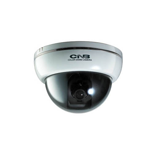

Soundy 1 Posted September 26, 2011 we use the CNB DBM-20VD/DBM-21VD for hall ways in hotels. which are well priced with 1 video balun on each floor. Have you ever used the CNB DBM-24VF? Do you think IR is needed for interior hallways of a hotel? The DBM-24VF is the same camera as the VCM/VBM-24VF, just in a non-vandal-resistant plastic housing. It should work fine. IR should NOT be needed in a hotel's public areas - keep in mind these areas will need to be well-lit 24/7 anyway. Share this post Link to post Share on other sites

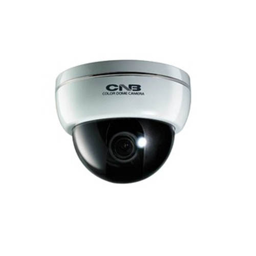

JackOfAllTrades 0 Posted September 26, 2011 hi. for your main areas the DBM-24vf is a good camera to use. Hall ways no need for VF as they are narrow then you only need the DFL-20S/DFL-21S. Do you think getting the CNB DBM-20VDL-W , which has a vari-focal lens is worth the extra $40 per camera or is vari-focal not needed in the hallways? Will the Qvis HD Pro-Lite DVR work well with the CNB cameras? Share this post Link to post Share on other sites
Soundy 1 Posted September 26, 2011 Depends on the lens it does come with. The DFL-20S includes a 3.8mm lens, which may or may not be wide enough for your needs. The DBM-20VDL has a 3.8-9.5mm lens, which will let you zoom in tighter but no wider. Share this post Link to post Share on other sites
JackOfAllTrades 0 Posted September 26, 2011 Depends on the lens it does come with. The DFL-20S includes a 3.8mm lens, which may or may not be wide enough for your needs. The DBM-20VDL has a 3.8-9.5mm lens, which will let you zoom in tighter but no wider. You recommended the VCM-24VF for outdoor use, does it have IR? From the specs I can't find IR as a listed option. Share this post Link to post Share on other sites
Soundy 1 Posted September 26, 2011 It doesn't include IR. It's a true day/night with excellent low-light response - in most cases, it doesn't NEED IR. Share this post Link to post Share on other sites

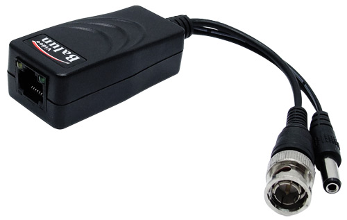

JackOfAllTrades 0 Posted September 27, 2011 In regards to the Cat5e cables. I found these: Shielded Cat5E 350MHz Molded Patch Cable Certification: TIA/EIA T568B (AT&T 258A) Wired STP Shielded Twist Pair CM Type PVC Jacket 26AWG 4pair Stranded Copper Wire 50 Micron Gold Plated RJ45 Plug Will these work good for the video & power pull? Is it a good idea to get "shielded" cables? PS - I am down to the final list and will post my final ordering list in a day or two of what I am getting to do this hotel install. THANKS AGAIN FOR EVERYONE'S HELP! You guys have been a huge help! Share this post Link to post Share on other sites
Soundy 1 Posted September 27, 2011 In regards to the Cat5e cables. I found these: Shielded Cat5E 350MHz Molded Patch Cable Certification: TIA/EIA T568B (AT&T 258A) Wired STP Shielded Twist Pair CM Type PVC Jacket 26AWG 4pair Stranded Copper Wire 50 Micron Gold Plated RJ45 Plug Will these work good for the video & power pull? Is it a good idea to get "shielded" cables? STP is overkill unless you're dealing with REALLY noisy environments. It also tends to cost up to 3x as much as unshielded (you're probably paying a buttload extra for those "gold plated" plugs, too). Share this post Link to post Share on other sites
JackOfAllTrades 0 Posted September 27, 2011 STP is overkill unless you're dealing with REALLY noisy environments. It also tends to cost up to 3x as much as unshielded (you're probably paying a buttload extra for those "gold plated" plugs, too). I will be pulling the cable through a lot of florescent light areas and ceiling area A/C systems. For 100 feet of Cat5e with RJ45 plugs on each end, they charge $22. Share this post Link to post Share on other sites

Numb-nuts 1 Posted September 29, 2011 I echo the use of domes with CAT5 and passive baluns, ( I use pigtail baluns because of the space of inputs at the DVR. You can use the CAT5 thus, a single pair for video signal and the remaining three pairs for DC Power. I take the remaining three pairs and split one pair and add to the others for power. I would then use a boxed Power distribution unit close to the DVR. One word of advice, terminate your CAT5 ends with chord end ferrules crimped on and your 'screw-down' connections will be more reliable. Just one word of caution when using CAT5, be careful NOT to make changes of direction too tight or you can affect the integrity of your cable. CAT5 can be quite brittle. The other thing is get some advice about which baluns you require from your supplier. Bear in mind that runs over 300m - 400m may require an active balun (powered) Both CNB and Dahua are good brands by all accounts. Try to buy domes with varifocal lenses to give you some flexibility in placement. Steer clear of KITS! Share this post Link to post Share on other sites

tomcctv 187 Posted September 30, 2011 Hi. i would hold off on ordering the EV16P-VPS – 16 Channel passive balun receiver & power supply hub and just use baluns at each end Main Hotel Areas:CNB DBM-24VF (3 total) • Ultra High Resolution : 600 TV Lines (BW 650TV Lines) • True Day/Night • Digital Noise Reduction (DNR) • Auto White Balance • AGC, SBLC, Flickerless • 1/3" IT CCD • 2.8-10.5mm auto iris lens • Min. Illumination : 0.005Lux • 3-Axis Movement for Free Lens Rotation • Dual Voltage 24VAC/12VDC Hotel Hallways:CNB DFL-20S CNB (6 total) CNB DFL-20S Main Features: • Ultra High Resolution : 600 TV Lines (BW 650TV Lines) • Auto White Balance • AGC, SBLC, Flickerless • 1/3" IT CCD • Fixed Lens(f=3.8mm) • Min. Illumination : 0.05Lux • 3-Axis Movement for Free Lens Rotation • 12VDC Exterior Cameras:CNB LDM-20S OUTDOOR IR DOME (3 total) this is not an external camera DID you mean the CNB LDM20VF ??? Share this post Link to post Share on other sites
Soundy 1 Posted September 30, 2011 Hi. i would hold off on ordering the EV16P-VPS – 16 Channel passive balun receiver & power supply hub and just use baluns at each end Any particular thinking behind that? Having just used two of these on a site, I can say it's way cleaner and easier than having to extend all those runs from baluns to power can, and really, no more expensive overall than separate baluns + power can. Share this post Link to post Share on other sites
