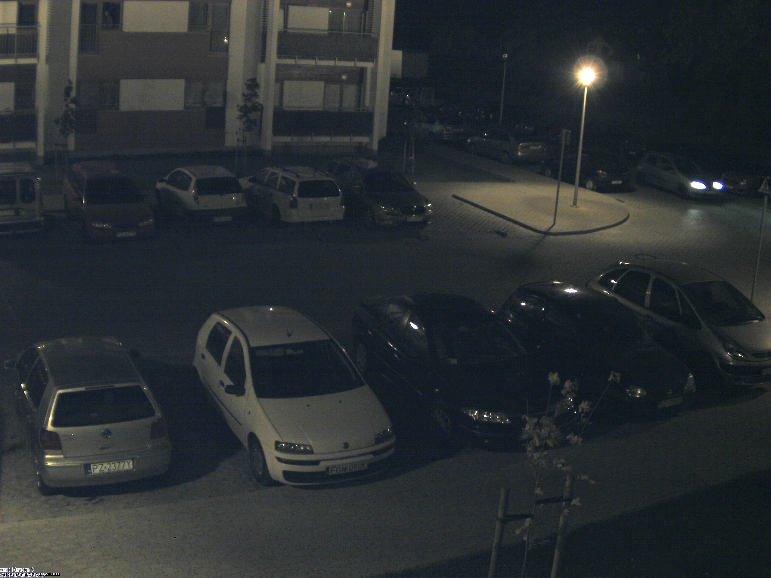

I recommend IQeye cameras, here is IQ755 shot, 1/50 shutter speed:
And IQeye have way better night cams, like IQM32 or IQ752. Is this quality that you are lookin' for?

This performance is fantastic, especially at that speed. Did you use IR?

No IR, only street lamp light.
