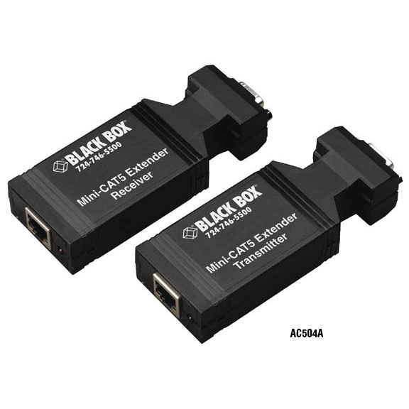

tomcctv 187 Posted November 10, 2011 hi like soundy says geo has a few config of cables some with audio some with spot monitor so alot of testing will be needed with a multi meter. or you could try black box (cat5 extender) Share this post Link to post Share on other sites
Soundy 1 Posted November 10, 2011 The other thing you could do to reduce the cable count is use some multi-channel baluns or passive hubs on both ends, and use Cat5e to run between the rooms - will be cleaner and quite possibly cheaper in the long run (especially if you factor in the time to terminate all those coax runs). Something like this, for example: http://www.nvt.com/content.php?type=product&key=3213s&cid=root - each Cat5e run can carry four video signals, so each DVR would require only four Cat5e runs, rather than 16 coax runs. Share this post Link to post Share on other sites
Soundy 1 Posted November 10, 2011 hi like soundy says geo has a few config of cables some with audio some with spot monitor so alot of testing will be needed with a multi meter. or you could try black box (cat5 extender) I doubt those would work - they look to be just VGA baluns, which really is just a three-channel balun, one for each signal line. These types of breakout cables don't conform to standard VGA pinouts, so something designed to transmit VGA wouldn't work. Share this post Link to post Share on other sites

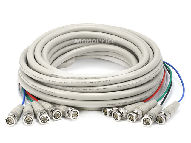

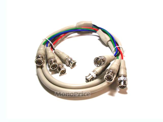

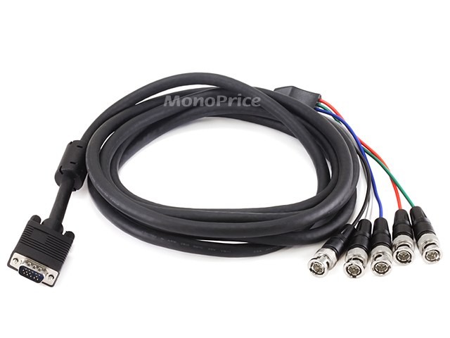

Soundy 1 Posted November 10, 2011 That second bundle would work, but it would get pretty messy as well, with the numbers the OP is talking about. Problem is, that has five connectors... the DVR inputs have eight. Pretty soon you end up with a mish-mash that's hard to keep track of... or a bunch of left-over cores. Share this post Link to post Share on other sites
HTElectrical 0 Posted November 10, 2011 That one is 25' and the cost is: 1 $15.59 2 - 9 $14.98 10 - 19 $14.38 20 - 49 $13.78 50+ $13.17 Share this post Link to post Share on other sites
