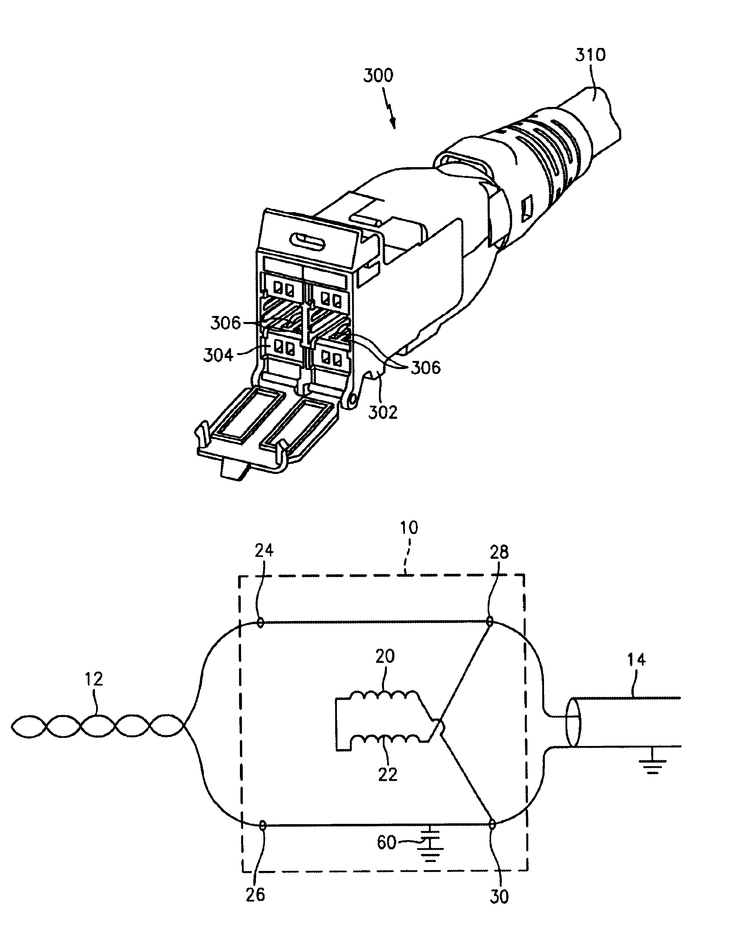

Soundy 1 Posted November 28, 2011 I would think not. Baluns have a transformer inside, wired like thus: Share this post Link to post Share on other sites
