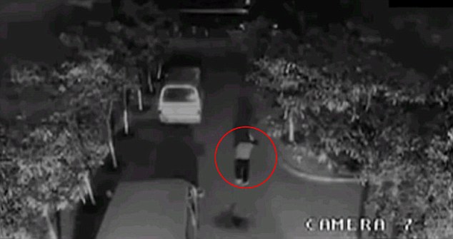

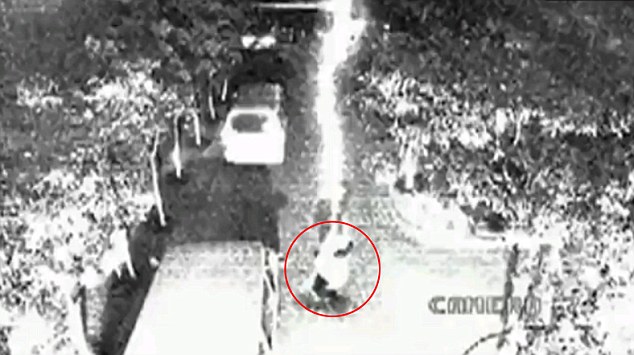

HeadsUp 0 Posted December 17, 2011 ouch so that was a fatal ? was he holding a mobile phone or umbrella in that raised arm ? i have had equipment damaged from a lightning strike to a tree about 40 feet away , yet it found its way into the wiring of our building , could this have occurred by the strike coming up the earth wire into equipment ?? i wouldnt mind so much losing a camera , but the DVR cost is around $ 2500 Share this post Link to post Share on other sites
tomcctv 187 Posted December 17, 2011 hi. the pics are from the paper ouch i think the guy said OUCH twice (he should have done the lottory that day) http://www.dailymail.co.uk/news/article-1382229/Man-survives-hit-lightning-TWICE-remarkable-CCTV-footage.html watch the guys feet .... burns the pavement. Share this post Link to post Share on other sites
HeadsUp 0 Posted December 17, 2011 not sure if that stain on the ground was blood . might have been other bodily fluids ? absolutely amazing . Share this post Link to post Share on other sites
