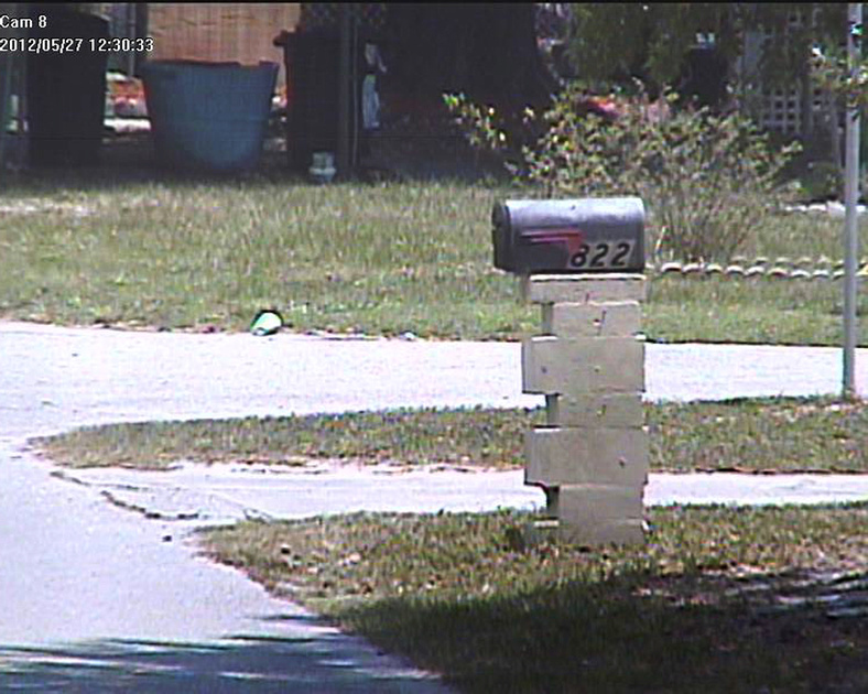

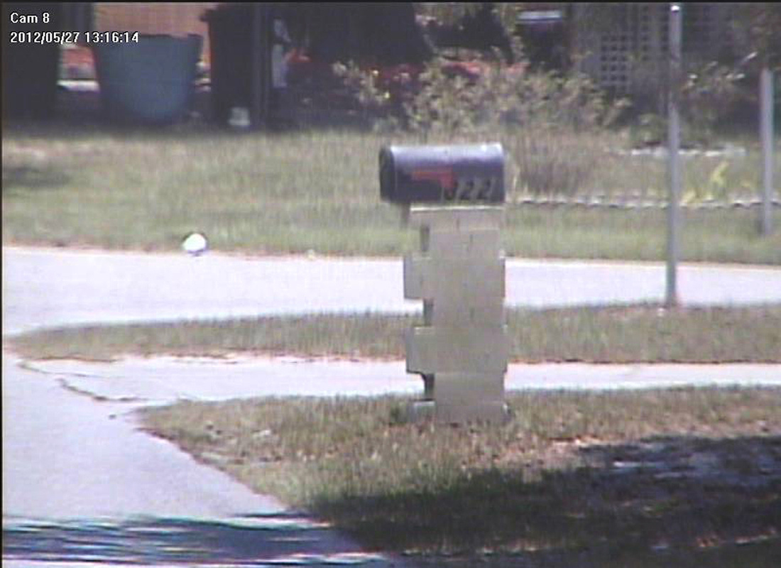

here is a sample of the difference IQ with and without the dome in place.
1. without dome. about 250 feet from camera.
2. with dome.

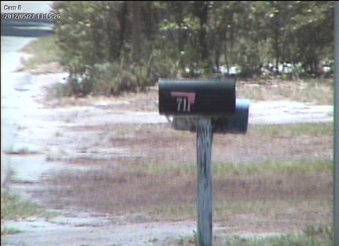

3. without dome, 200ft the other direction.
192531_1.jp
4. with dome.

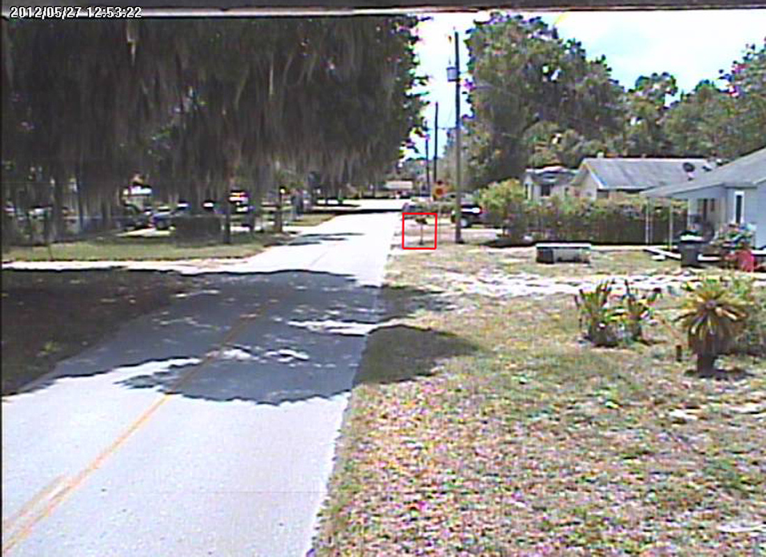

So you can get an idea how far away these are, here's a zoomed out image
that shows target area in a red square.
