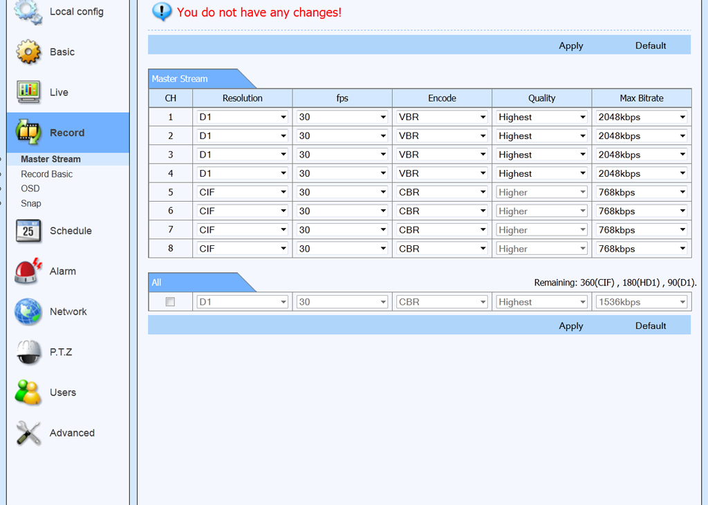

SublimitySam 0 Posted February 28, 2012 thinking about an upgrade to the QT454. I like the idea of D1 at 30fps on all 4 channels. and another over sales pitch by q-see its only 7,5 fps Nope! The QT series is full D1 on all channels. I've thouroughly studied the QT528 technical manual and it definately states 30 FPS on all channels, and CIF equaling 1/2 D1. I believe the manual. Share this post Link to post Share on other sites
tomcctv 187 Posted February 28, 2012 Nope! The QT series is full D1 on all channels. I've thouroughly studied the QT528 technical manual and it definately states 30 FPS on all channels, NOPE. dont get mixed up with viewing and recording. ..... second line of the manual also tells you real time only in cif. so its 25fps each channel at cif or 7.5fps at D1 and another over sales pitch by q-see its only 7,5 fps From there spec ---- Record Frame Rate (D1) 30FPS, (CIF) 30FPS which should say D1 30fps in total and cif 30fps each channel (total 120fps) if it was full D1 at 120fps why are they selling it as a realtime CIF Quality you can see and experience at an affordable price. This 4 channel DVR features real time CIF recording, or D1 recording at a lower frame rate, Share this post Link to post Share on other sites
SublimitySam 0 Posted February 29, 2012 A piece of screen print from the Q-see QT528 web client. I can't vouch for the QT 454 but it uses the same technical manual so I assume it is also 30 FPS in D1. As for CIF, well I guess it's also 30 FPS. Share this post Link to post Share on other sites

rory 0 Posted February 29, 2012 QT4 Series DVRs are set to record in real-time (30 frames per second) in the CIF format. Depending on the model, one or more channels may be set to record in the higher resolution in real-time, or all channels may record in D1, but at a reduced frame rate. QT5 Series DVRs, along with the QT454, are configured to record in real-time on all channels in the highresolution D1 format. The QT2124 can only record in the CIF format. http://www.q-see.com/files/manuals/QT%20Series%20Manual_web.pdf BTW, Dahua has D1 30fps record each channel also, on select DVRs. Share this post Link to post Share on other sites
