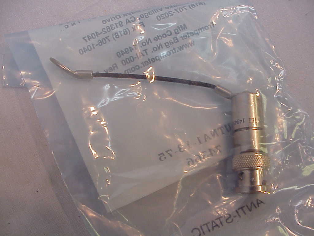

tomcctv 187 Posted March 12, 2012 Tried to replace outdoor camera and install a new one, but it seems to be a problem with the existing cable test cable with a terminator. and multimeter. if you get a bad or no reading then pull new cable. with everything CCTV the less joints and connections the better. was the old camera working before you changed it ??? Share this post Link to post Share on other sites
