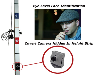

Soundy 1 Posted May 13, 2012 You'll have a tough time finding four IP cams for under $1000, but for a good start, you could check the banner ad to the left of this, showing a little 2MP dome... You should also consider some sort of WDR camera with a tight shot on the front door - will add a little more to the cost, but that that does is give you a detailed shot of everyone coming through the door. Alternatively, you can look at a height-strip camera to go beside the door to catch faces of people leaving. Lastly, you may also want to consider having a camera on the hallway leading to the bathroom. That hallway is a huge blind spot and it appears that the soda fountain will be located there. Good place for something to spill and someone slipping. As luck will have it, if something happens it will be in the area that doesn't have coverage. This is a good point: people mostly think about cameras to protect against theft and loss... but liability is important too. Someone slips and falls on a spill, they could sue, claiming the store should have cleaned it up... if the camera shows they spilled it their own dumb selves, then turned around and slipped on it right away, you're in the clear. Share this post Link to post Share on other sites
