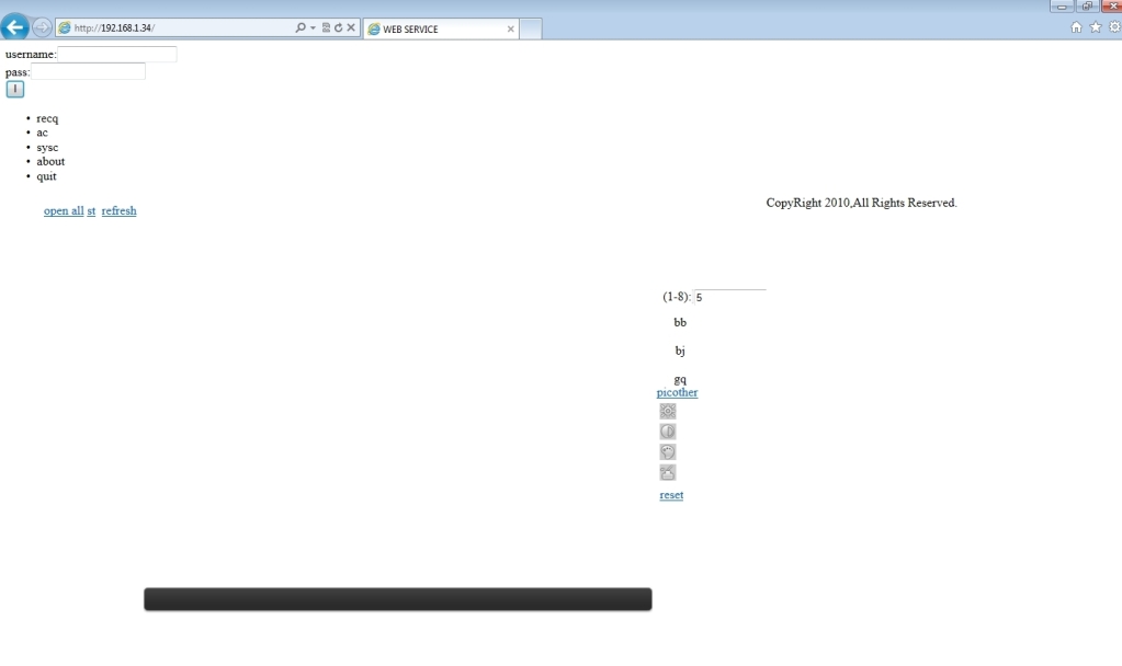

with it. The dvr works as normal through PSS on my windows machine, but when I log in using Explorer,
I get this weird screen.

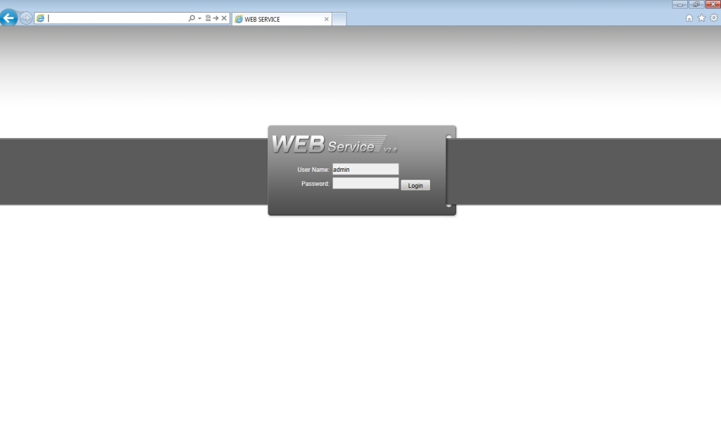

All of my other DVR's, same make, always give me the normal web service log in screen like this one
The DVR works fine in IDMSS and using PSS, but not in explorer. I've downloaded all the active x
that it asked for and I've put it in my trusted sites. Any ideas before I call my distributor tomorrow?
You need to select the option to view in Compatability Mode. It's the little squiggly lines on your address bar between the search icon and the reload icon. I can see it on your screenshot. Just click that and it will reload the page correctly.
I clicked on that and refreshed and it told me internet explorer cannot display the page. Than I clicked on
it again and refreshed and it gave me the old screen back. Any other ideas? I called the distributor on

Hi. i would remove your link. you have not done any protection on it.
everything works fine ...... you are best off removing all your dvr activex files and starting again.
Edited by Guest
Tom, I'll remove it in a few, thanks. I already deleted all active x in manage add ons and than reinstalled.
I have tons of dvrs I access in explorer and this is the only one doing this for me. Hopefully when I install
it tomorrow, I can view it from my home remotely so I can service it. Thanks.
