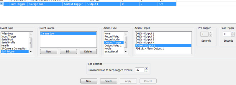

In exacq in the linking area you click on new, then choose soft trigger. Event source you then name it whatever you want, likely Garage Door. The next area to the right is action type, choose output trigger. Once you have that clicked then the available alarm outputs on your cameras should show up. Choose the correct camera output you want to use. The last option is time on the right, for how long to hold the output. That you might have to play with, but I can't imagine it needs more than a second and maybe not even that long.

I set up that trigger in exacq, and I hooked up a volt meter to my Axis 3346-VE output, and when I turn the soft trigger on, it outputs 3.3 volts DC So that is working.
Now, on to the more tricky part. I don't think my garage opener uses 3.3 volts, its probly more like 12 or 24 volts, I would assume? And also I'm not sure yet if the garage opener uses DC or AC power. The garage opener hasnt actually been installed yet, which is why I cant test it right now for voltage type. It is getting installed next week. I've been trying to find manuals/diagrams online for garage openers to see what kind of voltage they use, but havent found anything yet.
The other thing is, can I set up the trigger in exacq to be momentary? The post-trigger thing, if it set it to 1-second, doesnt do a 1-second momentary signal. It stays on for 1-second AFTER you turn the trigger off. So, currently, I have to turn the trigger on, then off real quick, which isnt that hard from the client software, but sometimes laggy/tricky using the iOS app, and I found myself often not able to get it to turn back off very quickly (sometimes took 3-5 seconds, which is probably too long?). It'd be cool if we could just have a momentary button, and choose how long it sends voltage out.
So I guess my two questions are: can we set a momentary trigger in exacq, instead of one that you have to turn on and off quickly, and does anybody know the voltage that most garage openers use (12v?), and what type of voltage it is (DC or AC)? Most likely, I will just end up hooking up a relay to complete the circuit, like the button in the garage does.
