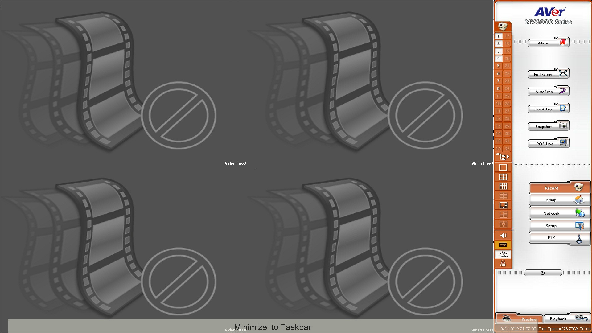

kdoske 0 Posted September 22, 2012 (edited) Finally minimize your Aver DVR and Player window to silent mode without typing in a password! I created this app so that it displays a very large button where the task bar would normally be. It is only visible when the DVR Module or the Player Module is running. If you click the button the program will close the Player (if its running) and minimize the DVR to the notification area (the little icons in clock area). To beat a dead horse, hitting the one button on my program would be the equivalent to hitting the power button, selecting minimize, entering your password. It essentially puts it in 'Silent mode' with no password at the click of one button. Its free for comercial use but donations are deffinately accepted. Paypal: kdoske@gmail.com I will accept feature request within reason. If you need a complete custom solution for something else pm me for a quote. Download (v0.01) The forum wont let me use so you are going to have to copy and past the links http://www.kdoske.com/Kdoske%20AverDVRMinimizer.exeor http://www.datafilehost.com/download-4793a6d3.html Limitations: Only tested on Windows7. Could work on others, I dunno. If you have any folder or another program that is named, 'DVR' or 'PLAYER' then the minimize button will appear. When you click the minimize button if you hold the button without releasing right away the taskbar will be activated and there is a chance it will not minimize the DVR. Click to Enlarge. I changed the button to read just 'Minimize' instead of 'minimize to taskbar'. Edited September 23, 2012 by Guest Share this post Link to post Share on other sites

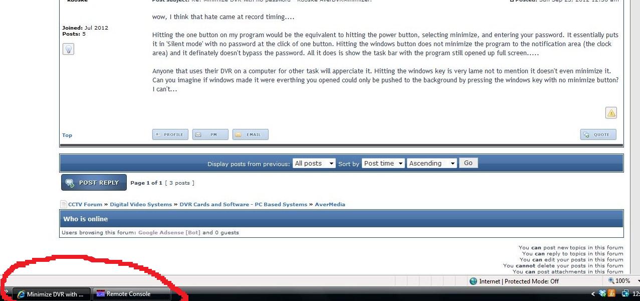

kdoske 0 Posted September 24, 2012 As requested!!! Just put the program in your windows startup folder and anytime you open up Aver Remote Console it will give it its own title bar and min/max buttons. Resizing will never be possible unless Aver incorperates it into the program themselves. That would involve a lot of internal code so the window would now how to rearrange everything in it according to its new size. I could add the resize option in this program I just made but if you resized the window all it would do is make it smaller but not rearrange anything so it would essentially just hide anything that was no longer in view. viewtopic.php?f=43&t=32458 Share this post Link to post Share on other sites
