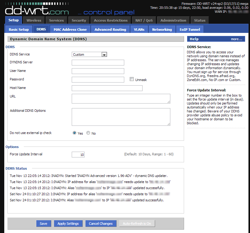

my preferred way to do this is using a router that supports user-defined ddns services, such as one running dd-wrt firmware (a few others do let you define your own ddns services as well). this way it doesn't rely on the dvr or a computer on the network being up or running properly in order for the ddns entry to be updated.
if that's not an option, you can run dynsite (http://noeld.com/services.htm) on any windows machine on your network.
it really doesn't matter whether the ddns updater runs on the dvr, a pc, or the router - it's updating the ddns server with the current "public" ip of your connection, an ip that all devices on the lan share.
