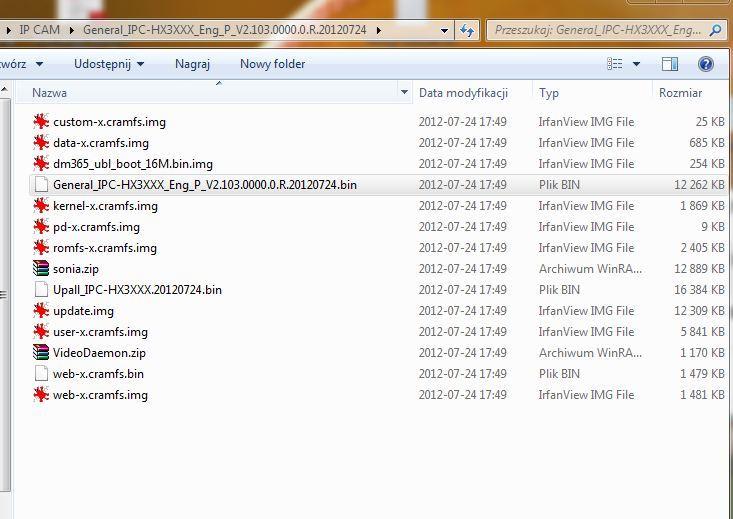

So, the file listed above contains, among other things, this firmware:
Upall_IPC-HX3XXX.20120911.bin
This is the generic firmware for the cameras matching that name template, which would include OP's cam, IPC-HDB3200C, however, the original zip file name usually specifies PAL vs NTSC. The web site says the VP-130N is PAL, so make sure that matches your camera. The internal file folder name looks like Vietnamese to me; it includes "nhận thẻ nhớ", which refers to the memory card.
The most recent version I've seen before this was 20120724, version 2.103.0000.0.R, so this one appears more recent, but sometimes Dahua messes up the date and version number, especially for branded cams.

I want used the second firmware "General_IPC-HX3XXX_Eng_P_V2.103.0000.0.R.20120724"
Now i can from webside System->Upgrade->Browse choose a files General_IPC-HX3XXX_Eng_P_V2.103.0000.0.R.20120724.bin, and thats all ?

Firs I was upgrade to 20120724 version and after that to 20120911 (2.103.0000.0.T, build : 2012-09-11).

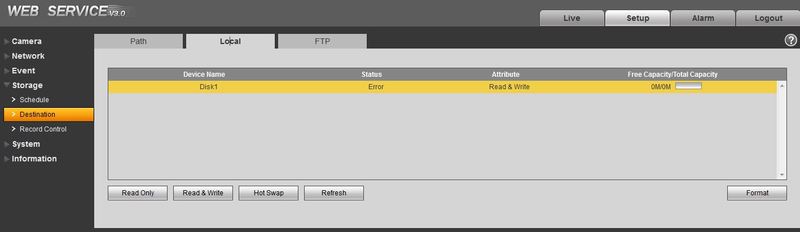

But still dosen't know why my sd card dosen't work
