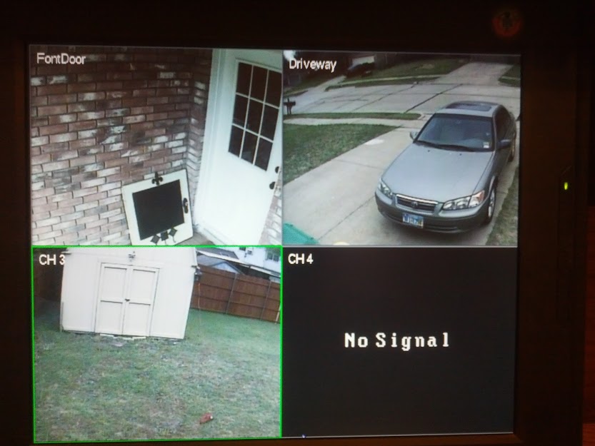

The camera system came in. The setup was pretty easy. Leaning the DVR software took a little bit of doing but its pretty simple now. I mounted 3 cameras where I think I want them with very temporary setups and wire runs. Bonus to me the cameras that it came with were actually CCD and not CMOS like I had thought they were. So the color is not too bad. The recorded video footage is not aweful, just a step above grainy gas station market videos. Daytime is great. Night time the driveway was doing something odd, i'll post a picture sometime this weekend to get help diagnosing that.

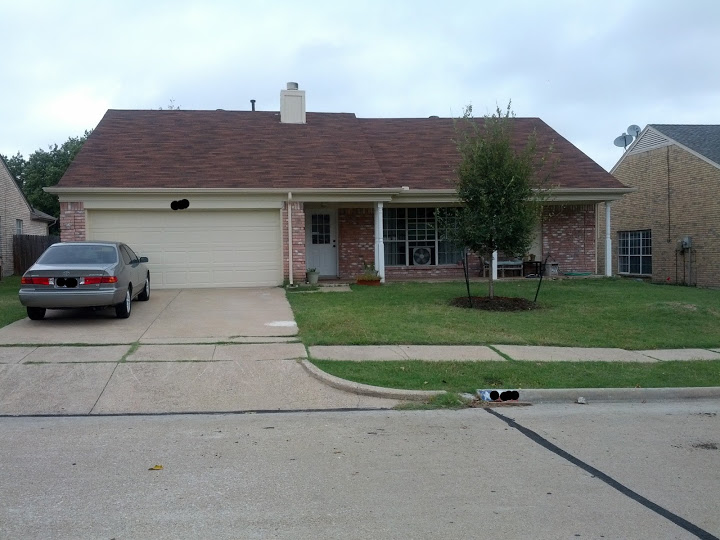

Here is a picture of how I have them now, minor tweaks and adjustments will be made when I do all the final wire runs. For now they're going to get bumped around anyways when I do the installations.
I am a picture nut, love taking pictures because its so much easier than trying to explain things... so sorry if I'm over picture-ing!

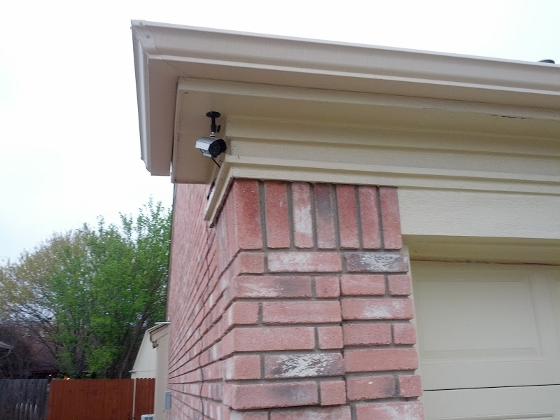

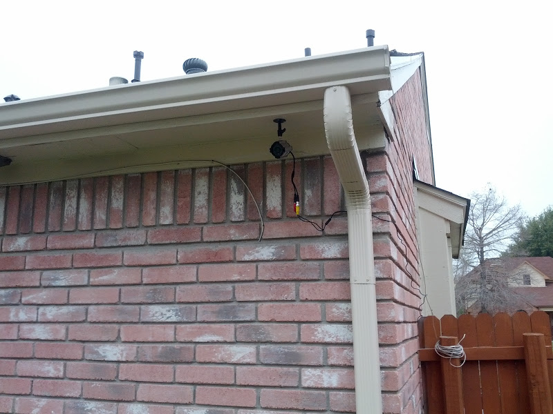

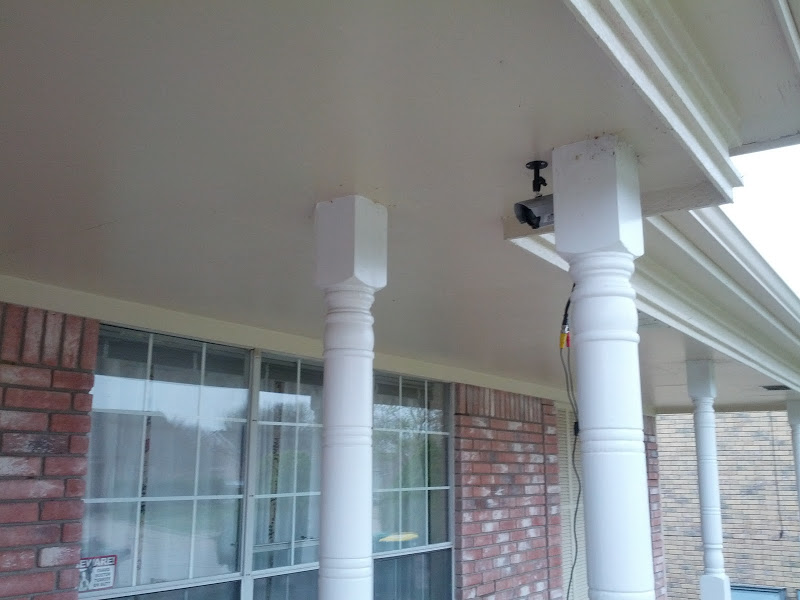

Here is pictures of the install so far.
Front Door - This one I will run the cables along the edge of the eve there to a soffit vent I have leading to the attic.
Driveway - The area right here has no direct access to the attic, I will need to run the cables over about 3-4feet to the right, drill a hole and route them through.
Backyard/Shed - There is a soffit vent just to the left here, I think I will be able to get to it, not directly, but via a hook and wire. In the attic there is about 10 feet of blown in insulation between the attic access and that vent.

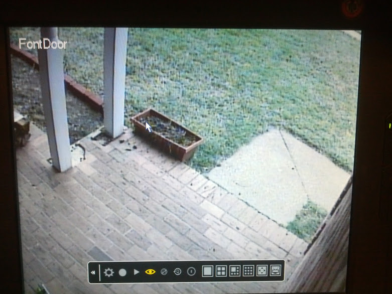

Hey, it works, right? Gives you a starting point if something goes wrong even if you don't have hi-def closeup face shots. I was a bit surprised to see the front door camera point AT the front door instead of away from it. More useful footage of the yard and mailbox and probably a better face shot of those standing at the front door if it was in the corner pointing outwards, but backlighting from the sun might darken faces too much at certain times of the day. Looks like you catch the mailbox at a distance in the corner of the driveway cam anyway. Just make sure you've got motion detection set sensitive enough that it records small people walking slowly from either direction towards your box if you don't dedicate a cam zoomed in and looking directly at the box.
You'll be able to recognize people you know or can find later fairly easily now. The next step is looking at sample faces (and plates) at different times of the day from recorded footage and see if you could recognize them in a lineup afterwards. Enjoy your new toy. You'll love being able to take a quick look at the monitor when you hear a bang at night and see what's going on.

Regarding the front door, it just seemed really "in your face" there because the ceiling is so low there, it doesn't show it very well there but the top of the door frame is pretty much the ceiling there. Thats why I wanted to try the other direction first, see how well you can see folks coming, side profile faces and that kind of thing. I'll give it a shot the other direction too.
That videosecu dome you were looking at would be less visually aggressive than the bullet both because it is a dome and the white would blend in better. Bubble domes are even better because the cam isn't staring you in the face.
I think the videosecu dome is also 3.6mm and if so I will be left with pretty much the same field of view. This is what i get putting the camera to the left of the door.
Pointed up higher?
I can see the mailboxes, and the pathway to the door, but somebody standing at the door I would only see the top of their head and its like you mentioned before with the sunlight washing out faces. Its not ideal but the way I have it pointed at the door I will at least be able to see who and how many people are there. I will probably put a camera on the far right side of the porch, it will either cover the mailboxes or I can point it at the rest of the front porch.
"FontDoor", I like it!
I think it looks like what you got would give you something for a minimum investment. To optimise it, you may want to go walk around the car, mailbox and front door to see how a person looks in the scene as you adjust the cameras. The driveway view is nice that it gets the mailbox as a bonus but if it means cropping out someone on the driver side of your car it may not be worth it for example. You just got to test it and keep adjusting its location and angle until you are happy with it. Even with all that though i have found the real test comes as visitors approach your property since they won't be posing for the camera.
Pointed up higher?
I am facing a similar problem with the camera at my front door. If it were me I would search for a dome that has a wide dynamic range(WDR) that you can replace it with someday in the future. Being analog it should not be too expensive. It will give you the in your face view without being quite in your face like the bullet.
Like blakem said, WDR is important to get unlit detail when harsh light is present in part of the shot, as is BLC (backlight compensation) with the sun in the background or even the ability to set different exposure zones if you want the cam to prioritize, say, your porch (works for faces at the door in extra shadow in the day and because the porchlight lights it better at night than the yard).

I'll be honest, I was surprised by the screen shots you provided.
With your budget it will be important to spend a lot of time on the placement/settings.
Just like you have them now, Record driving down the street both ways, walk near the mailbox,
Walk around the house, Pretend to "Stake Out" your own home. Actually pretend to try and break into your own home.
Look at that recorded footage and fine tune the camera placements.

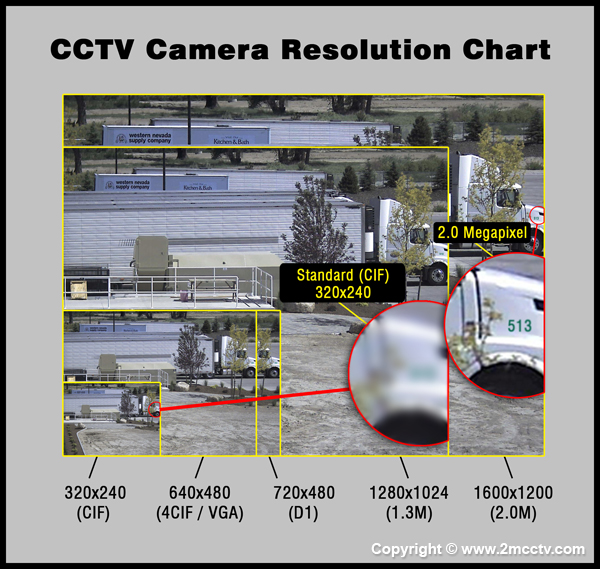

btw, Here's a resolution chart/
