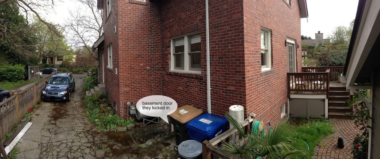

Here is the main area (90 degree view) I want to cover with at least 2 cameras. Another on the front door and maybe one on the other side of the house.

There's a lot you can do in addition to cameras, such as motion detected security lighting. They make a superb motion detection light which holds two 100-watt flood lights (I use 90-watt equivilent LED spots which are very expensive). The fixture is $50.00. On at dusk, off at dawn and a bunch of other user definable options. Mount a couple high up and you'll make that area very uncomfortable. In addition, a steel Bilco type basement door will fortify that entrance they kicked in and to get one of those suckers open they'll need a torch. But as for cameras, you really need to start with a budget. You can get decent (not great) 2 megapixel cameras for $200.00 each. Don't skimp on the PC, get an i7 machine with a 64-bit OS. You're going to need an 8-port POE switch with all 8 ports supplying POE. You're going to need a broadband internet connection and a smartphone (or other such mobile device).
Five cameras is $1,000.00. A basic i7 machine is (at least) $650.00. A POE switch that supports 8 POE ports is probably around $250.00. $150.00 for DIY Cat5e cabling. $150.00 for software and apps? $200.00 for stuff I forgot. I'm thinkin' you're looking at approximately $2,350.00 for a decent 5-camera system which would allow you to easily add additional cams for $200.00 each.

Yes, I have such a light on the side of the house but will improve on it as the motion sensing has it flashing at cats and raccoons all night and it throws a lot of light were I don't necessarily need it or where my neighbors want it. It will be replace with multiple fixtures so I can better light the area not only for security but usability.
The basement door is being replaced by the insurance company with a similar but according to the contractor a slightly stouter door. I'll make sure it's installed with 3" screws instead of 1/2" and I'll add a crossbar on the inside. The cost of installing a Bilco would easily cover the costs you lay out.

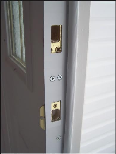

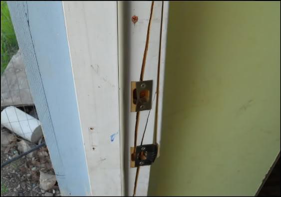

I suggest reinforcing the entry points. Doors #1.
Basically a thin steel frame inside the door frame.... With Holes cut out for the locks.
Something like this... It's basically Kick proof.

For the door reinforcements, go to Amazon and search on door reinforcement. There are lots of reviews of them, and it makes it easier to pick the ones that will work for you.
Door jamb armor or ezarmor are good too since they reinforce the door, door jamb and hinges.
