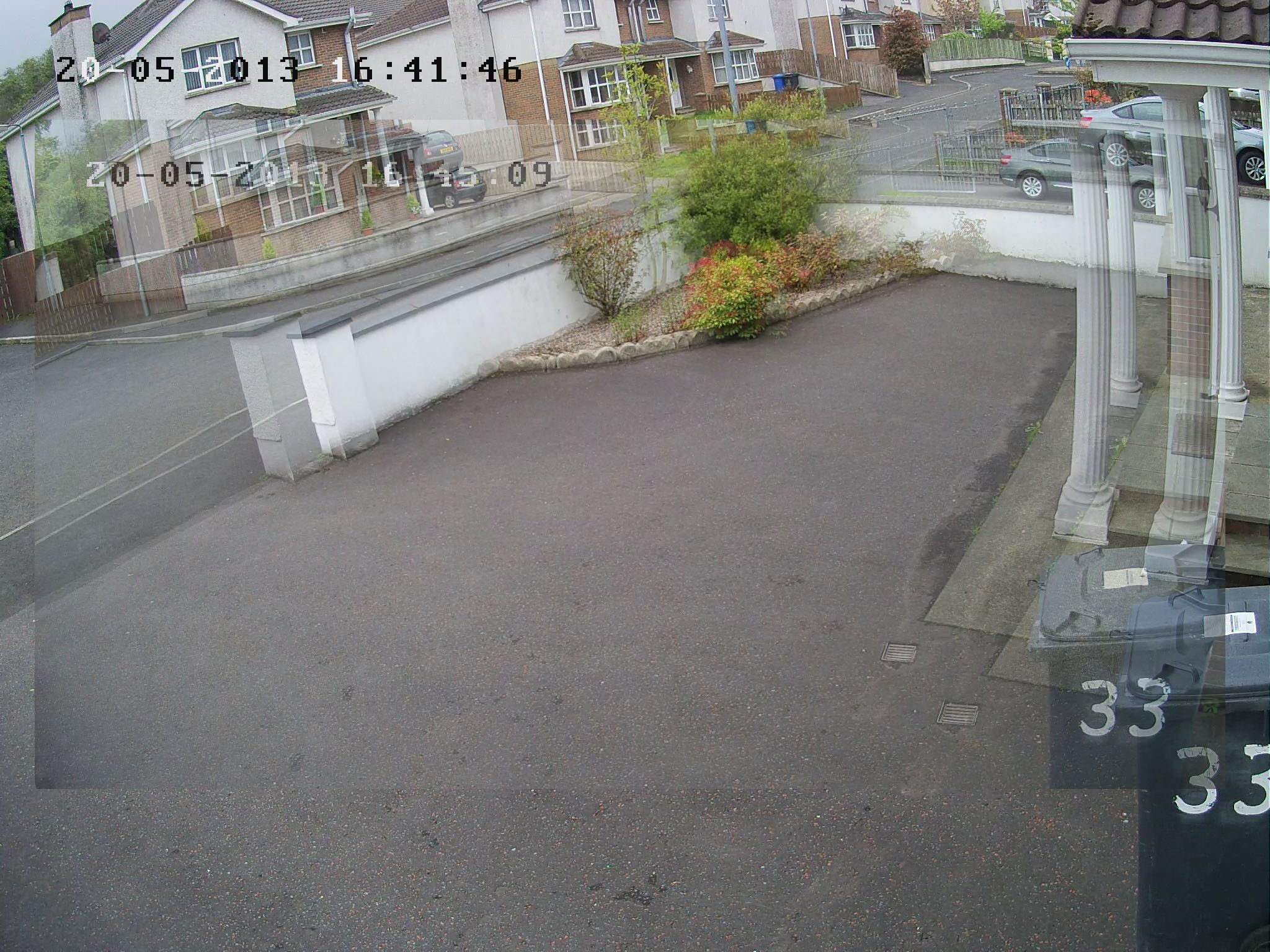

For those that loaded Hikvision firmware on their Swann/Lorex 1080P IR Bullet camera to take advantage of free 3MP resolution can rest easy knowing that there's no difference between the cameras that I can discern. I did the same test of overlaying the image from 1080P over a 3MP image and it's the same for a real Hikvision 3MP bullet vs. the Swann 1080P bullet.
When it goes from 3MP to 1080P, most cameras do a crop but on Hikvision cameras, it appears to do a combination of resizing the image and cropping top and bottom from 4:3 to 16:9 aspect ratio. It actually shows a more wider image, which means when it goes from 1080 to 3MP, it us cropping a little from the sides to make the transition to the 4:3 aspect ratio.

So, it appears that both act the same, as Buellwinkle found, which indicates that the Hik 3MP mode is actually a scaled (interpolated) output from the sensor. The pics of the sensor make it appear to be a 16:9 sensor, while a typical 3MP sensor is a 4:3 sensor, and the 1080P uses the full width with fewer vertical pixels. This is how the Dahua 3MP appears to work.
Unfortunately, it's very hard to say for sure what's going on internally, but it's pretty clear from Buellwinkle's image that it's not a true 3MP, since the 3MP spec has more horizontal pixels than the 1080P, while this image has fewer.
An estimate of the Swann's image showed it to be about 2.3MP equivalent in the 3MP image, assuming the 1080p image is true 1080p. It looks like the Hik 3MP cam has the exact same image proportions, but I haven't checked them closely.

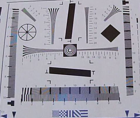

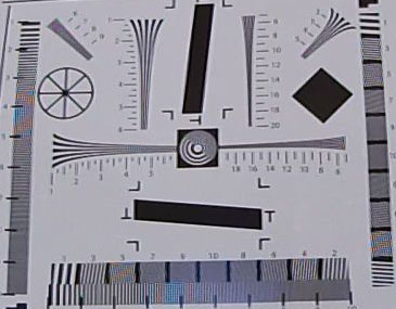

I got the 3MP Hikvision DS-2CD2132-I Dome in my hands. Using an ISO 12233 resolution chart I took two snapshots one at 1080P and one at 3MP and then took a crop of the same area of the chart. Since this is a 2.8mm lens, I had to be pretty close, maybe 3' away from the chart but focus remained sharp. Also, I make no claims that this camera is identical to the Lorex domes at Costco, so don't blame me if you can't flash the Lorex to be like the Hikvision branded camera or that it's not exactly the same. This camera came directly from Hikvision in Los Angeles.
3MP mode
1080P (2MP) mode
There's considerably more pixels in 3MP mode than 2MP but that part is expected and does not relate to true resolution. But given that, is the pixilation the same, if so, then 3MP is truly 3MP relative to 2MP (1080P). Look at the converging line, for example the upper right where you can clearly see that the effective resolution in 3MP mode is far superior to the camera in 2MP mode.
The notion that this is really a 2MP (1080P) camera that has been extrapolated to 3MP is ridiculous. The effective resolution in 3MP is significantly higher than in 2MP mode. Also, for what it's worth, contrary this camera is full 30 FPS in both 3MP and 1080P mode.

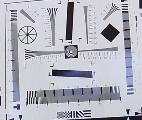

I also took as snapshot of the same area with the ACTi E32, a 3MP bullet and I don't see any resolution difference between 3MP on either camera which further convinces me that these are true 3MP cameras. If anything, the Hikvision is higher resolution but I just unboxed these cameras, didn't have time to tweak any of the settings.
