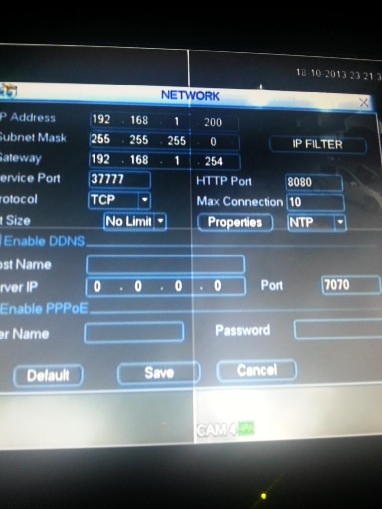

moved into a house a few weeks ago and the previous owner had CCTV installed into the house - the DVR is located in the cloak room next to the wash room - the DVR is a 8 phase capable model(allowing 8 inputs - but only 4 currently in use).
after getting a home network installed this week, i am trying to Firstly get my DVR set up onto my network. after watching a few youtube videos online i worked out that i had to set ip's and ports and stuff - being a IT wiz it wasn’t to bad following several tutorials and understanding what was going on.
the image below shows configuration of my DVR
*my intentions were to view my CCTV away from the house - so i had configured my BT homehub3 to allow port 8080 on 192.168.1.200*

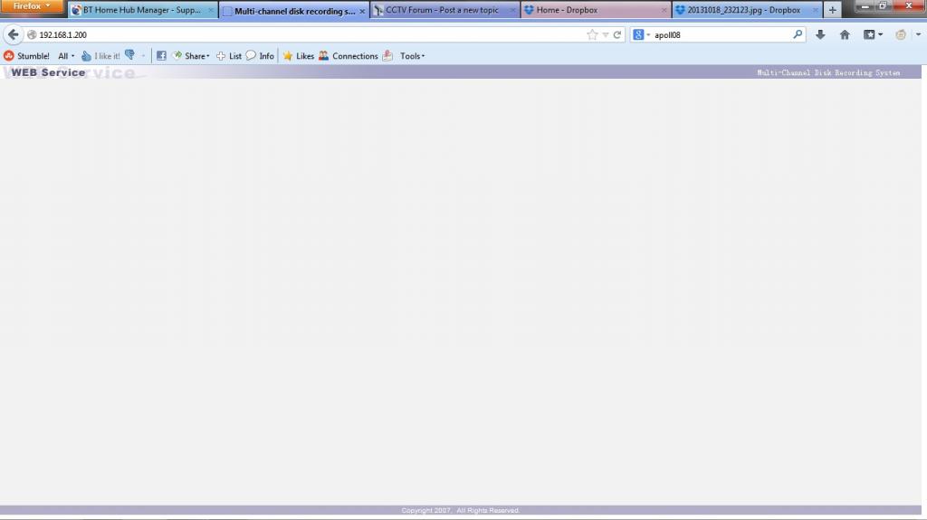

right so am i right in thinking when i try to access the DVR in my Local network i should be able to connect @ 192.168.1.200 - as configured?
either way i get as far as this:
i have pinged 192.168.1.200 - and i get a response.
anyone got any suggestions as to what is going on?

You need to open IE and enter http://192.168.1.200:8080 to view on your local network. To view remotely,
you can enter your external IP and colon 8080, but it's a good idea to set up a DDNS in case your IP changes.
I'm confused also, because your picture shows your using 192.168.1.254, not 200? And if you want to use your
cell phone remotely, you need to port forward 37777 to your dvr's IP as well.
Luckyfella,
.254 is the gateway (router), the DVR IP is indeed .200
And yes, you should be opening both ports 8080 and 37777 so you can access the DVR from outside the network. That looks like some old Dahua DVR.

I have tried to open 192.168.1.200:8080 in my local network and that should surly work, using both internet Explorer, Firefox, android browser. And im confused because I get the same for them all!! A header a footer looking like its about to load.

You NEED to have http:// in front of the IP when using IE. If you had port 80 rather than 8080, than you would be able to just
enter the IP in the URL bar and hit the dvr. Don't worry about the firmware, if it ain't broke, don't fix it.
