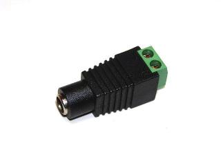

That green terminal block is your power line, its not using a 2.1mm jack
You will need to wire it up to a jack like this if you want to connect it to the old cable
Make sure you waterproof the connectors or your camera won't last very long
