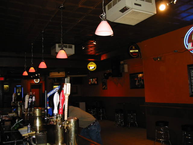

camera suggestion for this picture
l am going to try the wizzkid 46 dome with 2.6mm 6 mm vari lens,any other suggestions based on my bar would be gateful.
pictur looks pretty dark but since this picture was taken,there are 5 x30inch tv screens above the bar that give off a lot of light and also the drop down lights above the bartop is not used,so it is mainly neons and tvs.

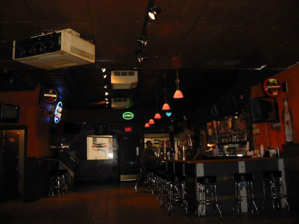

heres a better picture,hopefully this shows;

looks pretty dim, if you dont want to spend a fortune, use regular BW, if you can afford it, True Day Night, though from your images the lighting looks to low for it not to go into BW or be pixelesed in color.
BW cameras for sure. To dim to do color. You won't like the pixelized look of what a color camera would do in that situation. Even if it is a Day/Night camera. A Day/Night would be a waste of money.

The bar is not quite that dark as the picture appears,l will post a few more updated pictures tomorrow or later.

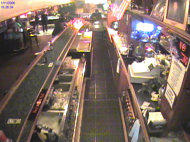

Here is a color picture in a BAR with a lot of light compared to your place and still the image is not as crisp as what you would get with a good BW dome like the WizKid.
That picture looks great. Is that a digital camera with the flash on?
Can't judge by that. Need to take pictures without the flash.

jasper, l wish l could get a picture like that!!thats my canon powershot a20 2 megapixel with the flash on!!

Rory ,that ge model looks great,l will check with howard at spytown for my cost and l think that would be the way to go for my situation.if l was to get a day/nite and l have enough light,which one??l will take some pictures tonite,l am going in to check in on everyone, and l will take a few more pics without the flash and then l can finally finish with my research for my cameras!!l will post the shots later and get a better picture of our light situation!!
