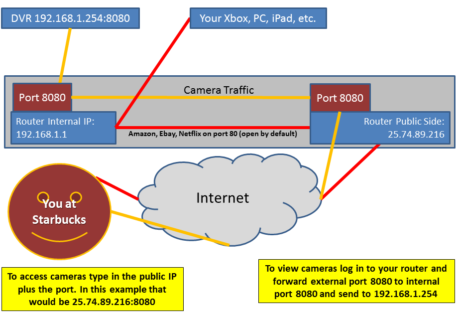

You are not forwarding the ports in the DVR, you are forwarding them in your router to MATCH the ports in your DVR. The router will ask you what ports to forward and what IP address to forward them to... in this case that would be the IP address of your DVR.
The diagram is extremely helpful. Can I just check a few things with real numbers.
