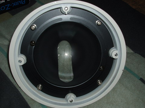

Here is a picture of a dome cover. You can see you can only go so far. And even if you removed the inside lining it is doubtful you could get the camera go all the way sideways. Espescially with a limited budget that might allow you to find one thay may do that.

I still don't think that dome will allow you to see all the way to one side like you think. You can tell by looking at the angle of the camera in the housing and the surrounding IR that would get in the way of it being tilted all the way over.
