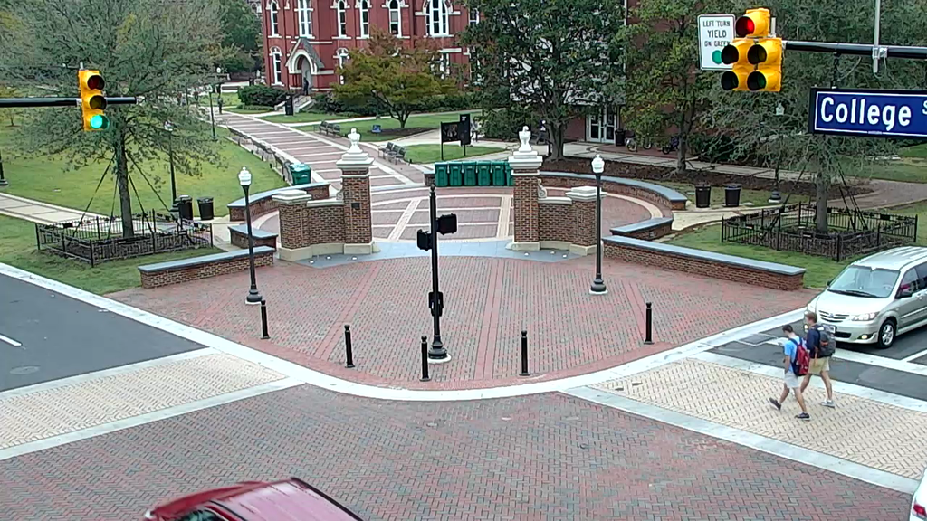

No these are at a University. Being recorded to a Dell Server using Genetec Security Center as the VMS.
No reason for us to record at 30fps. It's a waste of bandwidth and storage just to get a smooth picture. 15fps is fine.
Hanging from a traffic arm.
Wide Angle
30X Zoom
