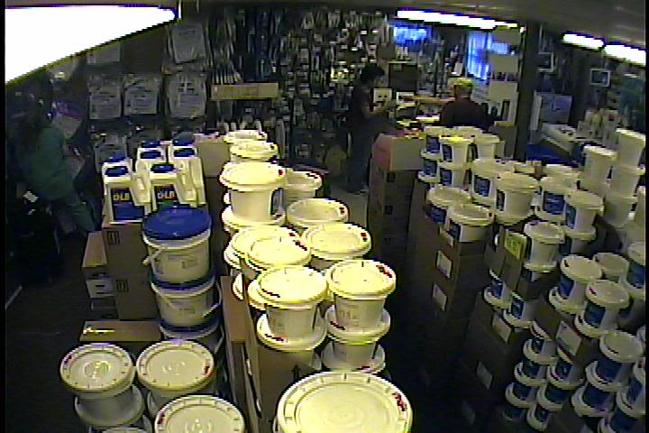

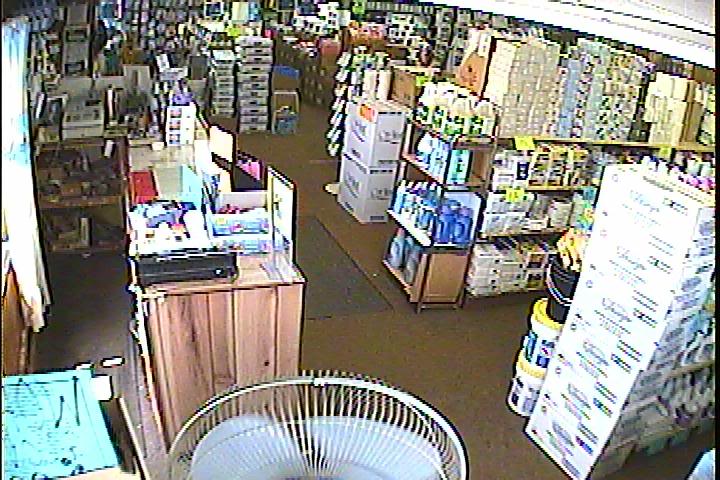

alright pictures are in... to me this is bad quality
Camera: NVCC-HD http://www.nuvico.com/product_detail.asp?strCategoryCD=CC001&strModel=&prod_cd=NP0024&Page=1
Camera: http://www.cctvspecialty.com/coinhirebuca.html
Camera: NVCC-W28IR12N http://www.nuvico.com/product_detail.asp?strCategoryCD=CC001&strModel=OUTDOOR%20BULLET%20IR%20CAMERAS&prod_cd=NP0039&Page=1
Camera: http://www.cctvspecialty.com/1webucawsose.html
Camera: http://www.cctvspecialty.com/codoinwaca48.html
btw i am definately NOT buying from www.cctvspecialty.com again.

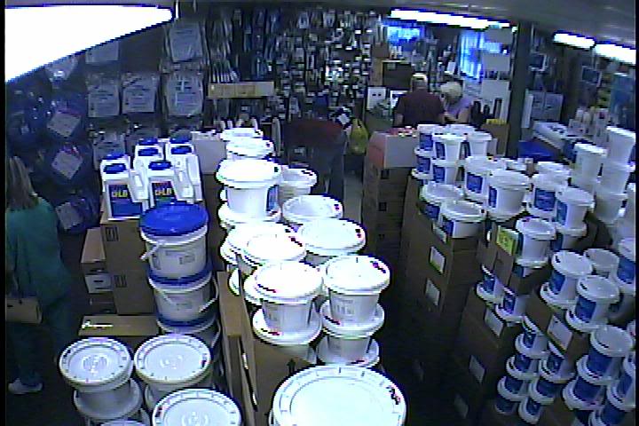

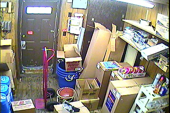

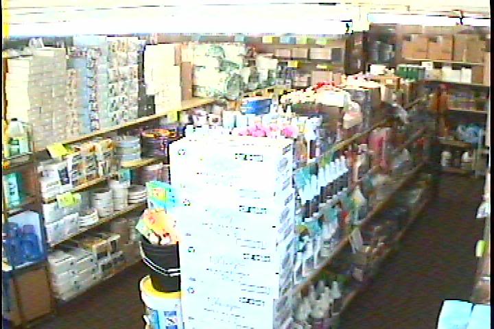

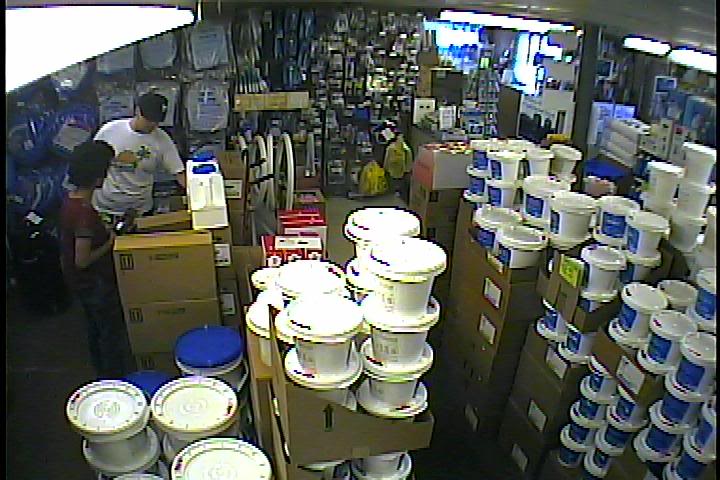

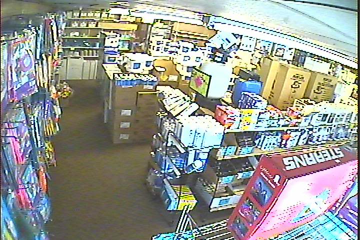

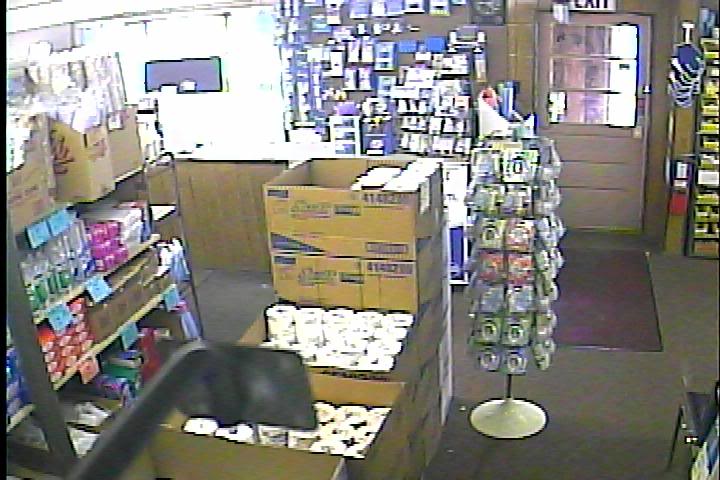

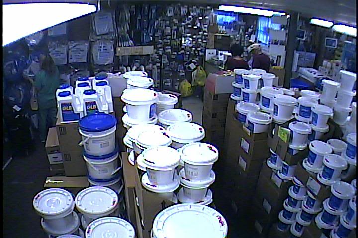

ok but see what i mean.... like in the pic u cant see the fuzzyneed but even though look how poor the quality is.. jagedy edges ...just poor..
is it that we are using wrong cabling? different way of crimping the BNC? making a proper BNC connection? to my best knowledge i know that if there is a problem it would have to be with the cabling/connectors
what do you guys think?

Well, to start, the first set of pictures, you are allowing the camera to pick up the flourecent light, that drives the CCD crazy, move it a little out of the way to see if it helps.
For the rest of them, they are not good cameras, expecially the one that's looking into the window, the camera is not a Wide Dynamic, which is why the glare is there.

but the edging on the items and people is that interlace?
would that go away if i tunrned on de-interlacing?

because there is a difference in computer ups and cctv ups as the computer ups will cause those small jagged lines in picture. The ups for cctv will not.
damn i didnt even know that.. um can you point me to the right direction as in which UPS to choose from ? for CCTV? and where to buy them?
there is no specific brand of ups shoudl get but the thing to keep in mind is these two terms.
1. Square waveform
2. Sine waveform
Square wave form is used in the cheaper ups products. Mostly used for computer systems. This is probably the kind that you are using as it is prone to putting those lines through your pictures.
Sine Waveform is a more expensive output but does not get into your video. When you are looking for a ups specify that you are needing a sine waveform ups. It will cost more but just as the saying goes.

well your problem right because ups with avr usually are not the cheapest line of ups available. And thats why you have not had any instances of the square wave form putting those lines in your pictures. But the basic ups do use square waveform and that is exactly the reason why he has those lines.

exactly why he has seen no lines. Because he uses sinewave output ups.
his main thing are the settings and the video card .. he has overlay disabled .. with Geo you get pixelised images in larger views when thats not enabled .. ..he needs to get a video card that supports overlay (and deinterlace) .. plus there are a couple other settings he needs to change .. cant get on Ultra VNC myself as they have no internet there yet though or id fix the other settings . ..
