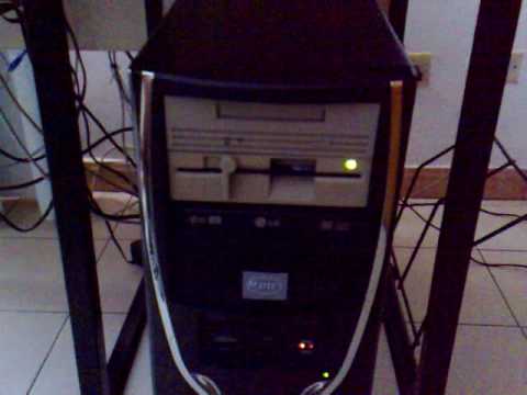

Everyone knows that a VMS software cannot turn this machine: 300181_1.jpg into this machine: https://preview.ibb.co/j2x4YF/Computer_Control_Room.jpg but if you can find any software that is capable to "huge" a machine let me know, I am highly interested I always wanted to run a data center on my own house . Okay, in a more serious note, you meant to say "HUG" not "HUGE" that "e" at the end completely changes the meaning of the word.
